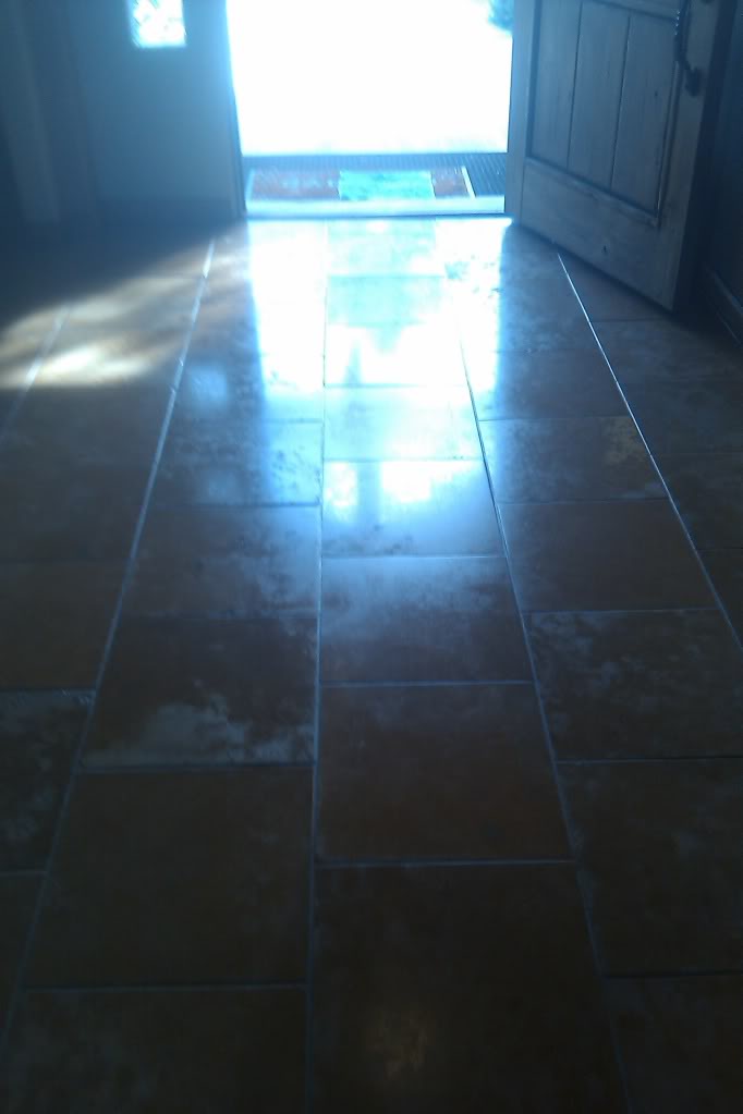

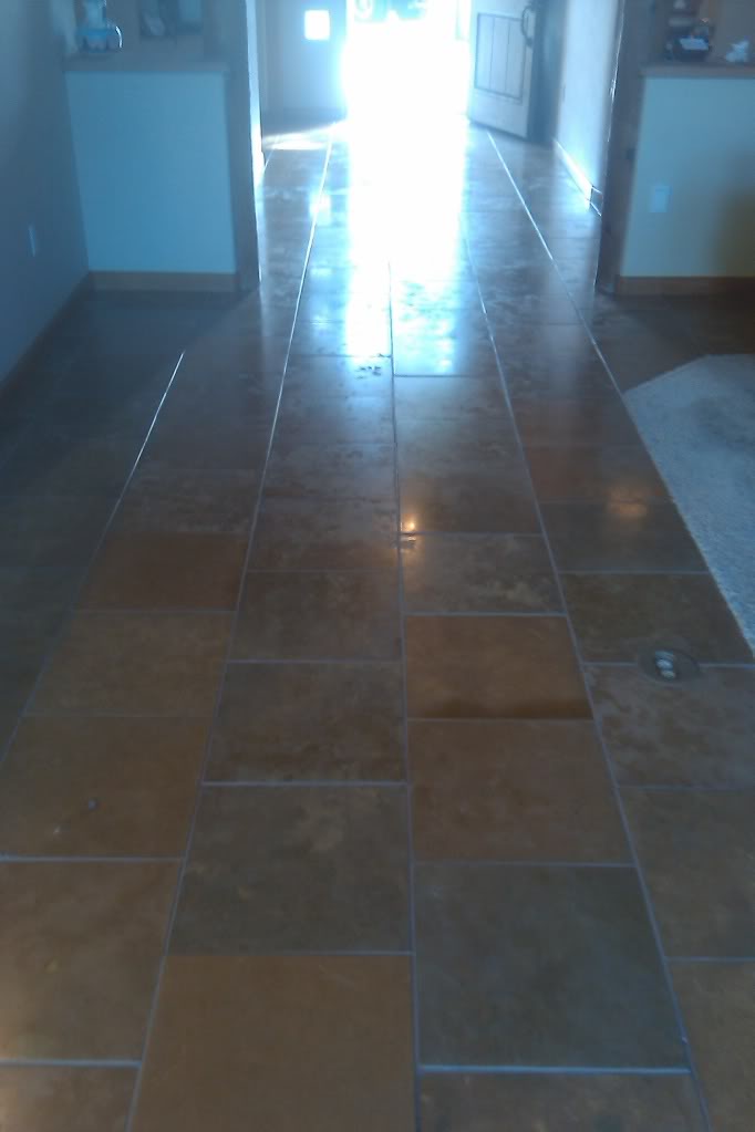

well I figured I would come out ok, the customer loved it and i collected 6987.53. I learned alot, I used powders, pastes, cheetah, monkeys and densifer.
they loved the floor and sent me home with 6 area rugs..... shiteatinggrin shiteatinggrin shiteatinggrin

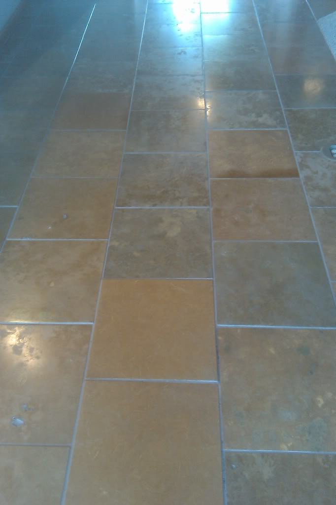

I would hit it with a 11000 grit monkey have 3 on hand with the lippage, 50 pounds of weight and 2 coats of densifer. done check in hand.. shiteatinggrin shiteatinggrin I have never had this problem with travertine. This stuff was soft... The 11ooo pad would remove scratches. I cant wait to try the cheetahs on a harder floor.

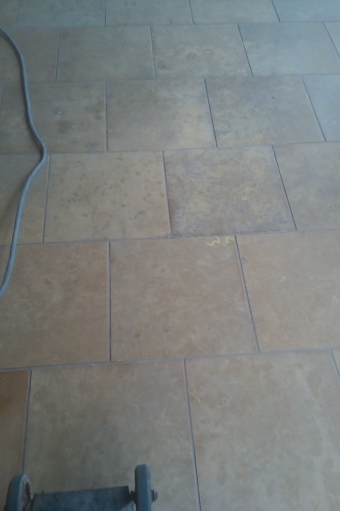

That looks like limestone Ron. Did you get to see the back of a spare tile. I'm glad the customer liked it. That stone was not made to take a polish but people get tired of the dull look and want bling.

Yes Al I actually went to the quarry where the cut the stone.. Funny thing the owner doesnt sell it any more due to the softness of the stone. I think we saved this floor from more damage...

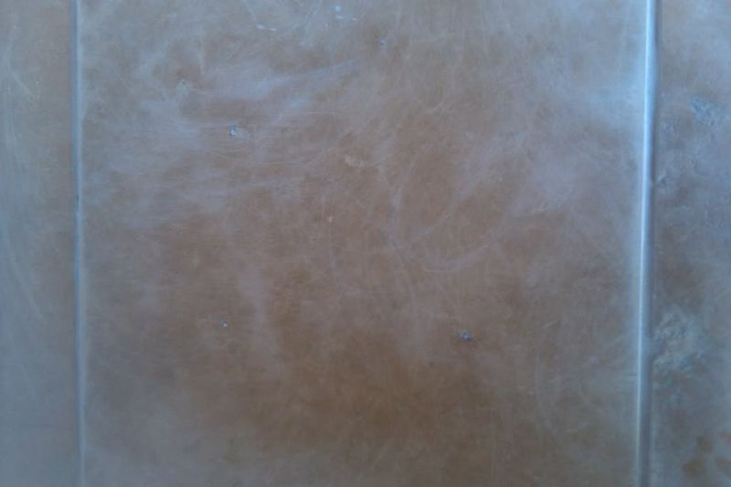

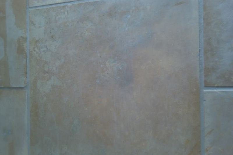

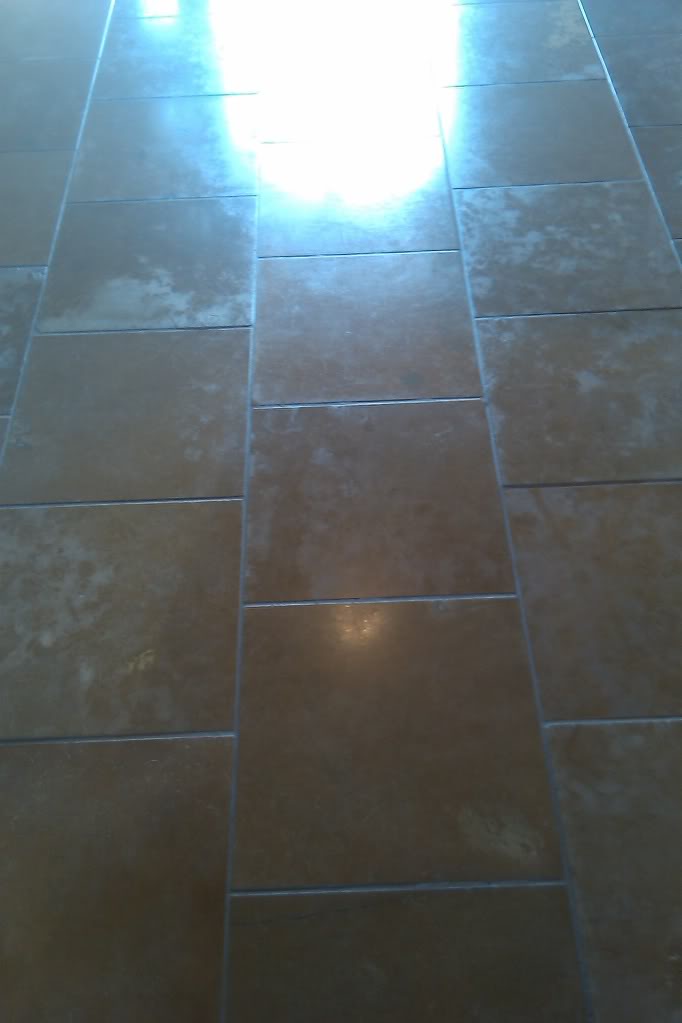

C
clean image
WOW,
Are those scratch patterns from the cheetahs?
What did the 2 coats of dentifier do?
Bellhop worked for his money those 35 hours
are those the after pics?
Maybee it the camera or lighting, , if so those after floor pictures look terrible
Nov 8, 2006
3,373
Albuquerque
Ron lippold
no there were scratches before we started. funny thing this stone was so soft that a 8000 pads even removed scratches. The densifer gave it the wet look and a differnt feel. They said if it has to be done once a year they dont care. It gave them more than they expected.

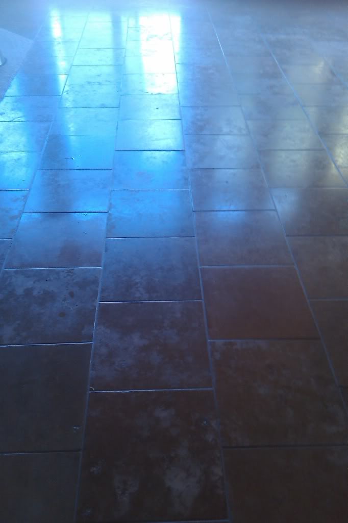

I am undecided if i like it or not.....that floor with the blotches in it looks crappy.....
but then again i wouldnt pay almost 7k to get it done either :shock: :shock: :shock: :shock: :shock: :shock:

doug when we got started that floor looked like shit, granted its not flat or perfect but it changed their whole house, thats why I got paid, I did not like it either but you have to draw the line in the sand and stake yor point, their happy I got paid and they love me. The floor looks a hell of alot better. cheaper than busting it up.....

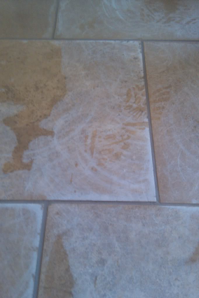

The more I look at the before pics, the more like mud they look. I see why they got rid of it. This floor was a bad idea from the start. Poor owners, I hope your solution lasts them a long while.
Doug, as you say, the densifier is used usually after the metal steps specially on the softer stuff. However some also use it as a last step, a few light coats and burnish in between. It's a lot cheaper then applying a guard.
