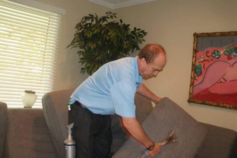

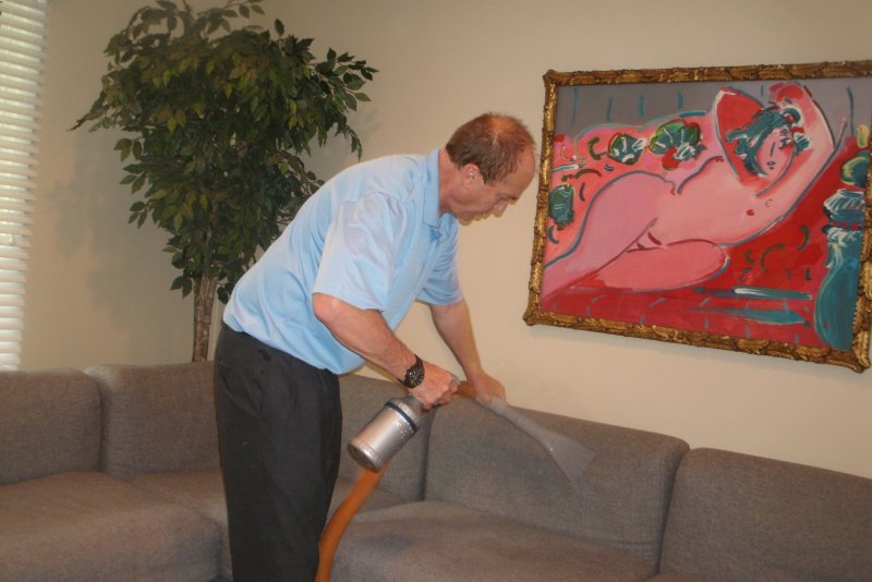

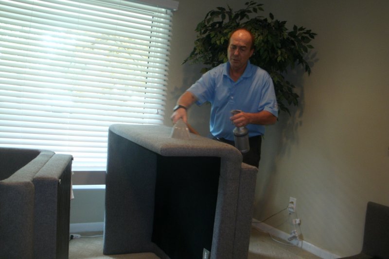

I clean a lot of upholstery and have very competitive prices which can be quoted over the phone. A 3 cushion sofa is $50, chair or recliner is $25. I can go blazing fast on all but very soiled fabrics which can really gobble the time. This lightly soiled wool sectional was $120. I apply Magic Potion in a trigger which is a neutral prespray, cleaner and rinse all in one and vac with a cuff all surfaces and that takes maybe 20-30 minutes:
And then a rinse with the Upholstery Pro set to continuous flow on more used areas which adds another 10 -20 minutes:
Reactions: Wing It
Magic potion is highly oxidized product that normally should not be applied to wool.
Your speed leaves me both envious and semi exhausted. I like the Matisse in the background, is that an original? :winky:
