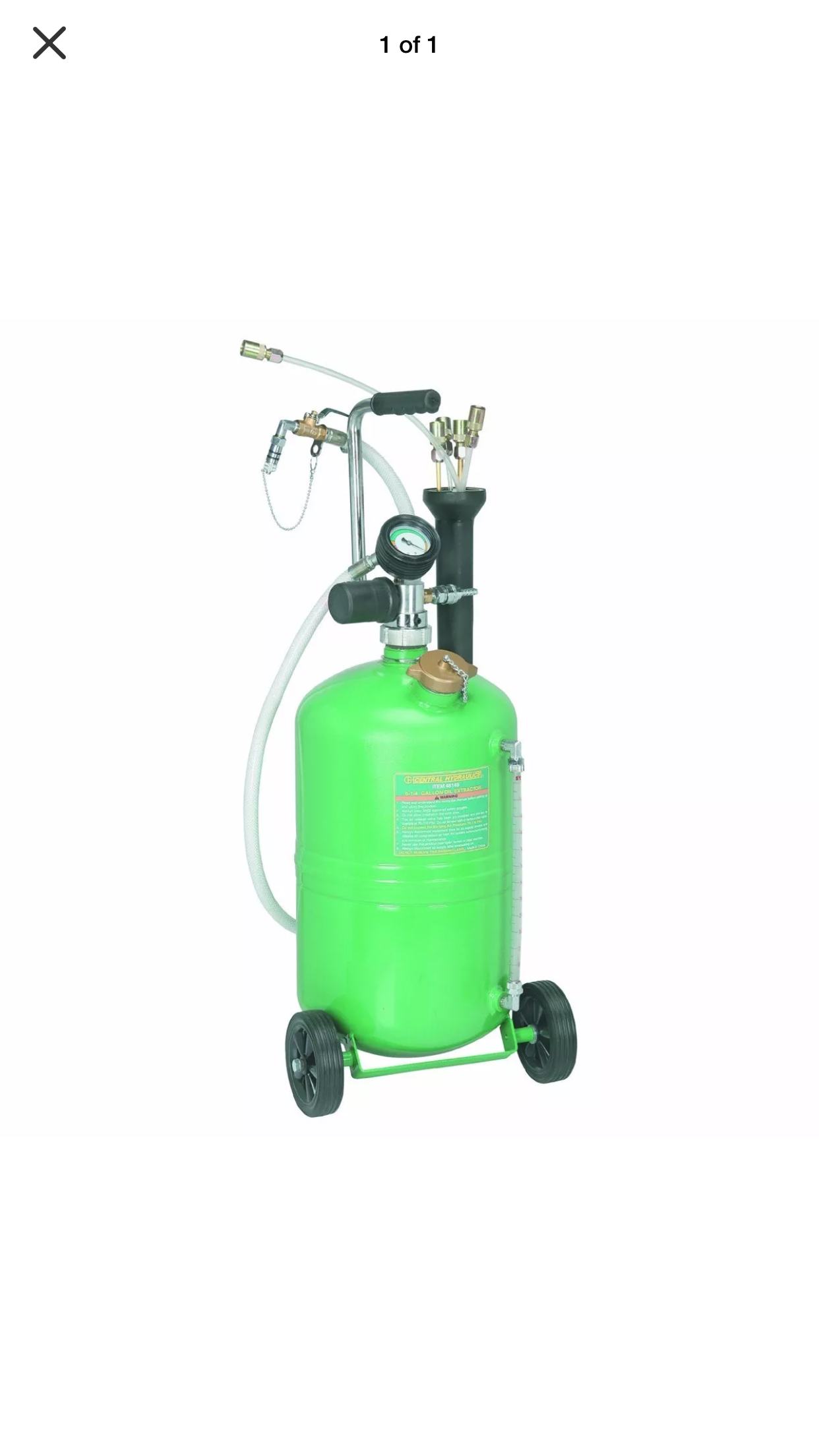

I use this. Got it at Harbor Freight and charge it up with the air compressor. Does an excellent job. It was a good purchase.

I use a pump up extractor like the one you posted Mike. Works great, the layout of the Cleanco's drains make it slow as molasses otherwise.

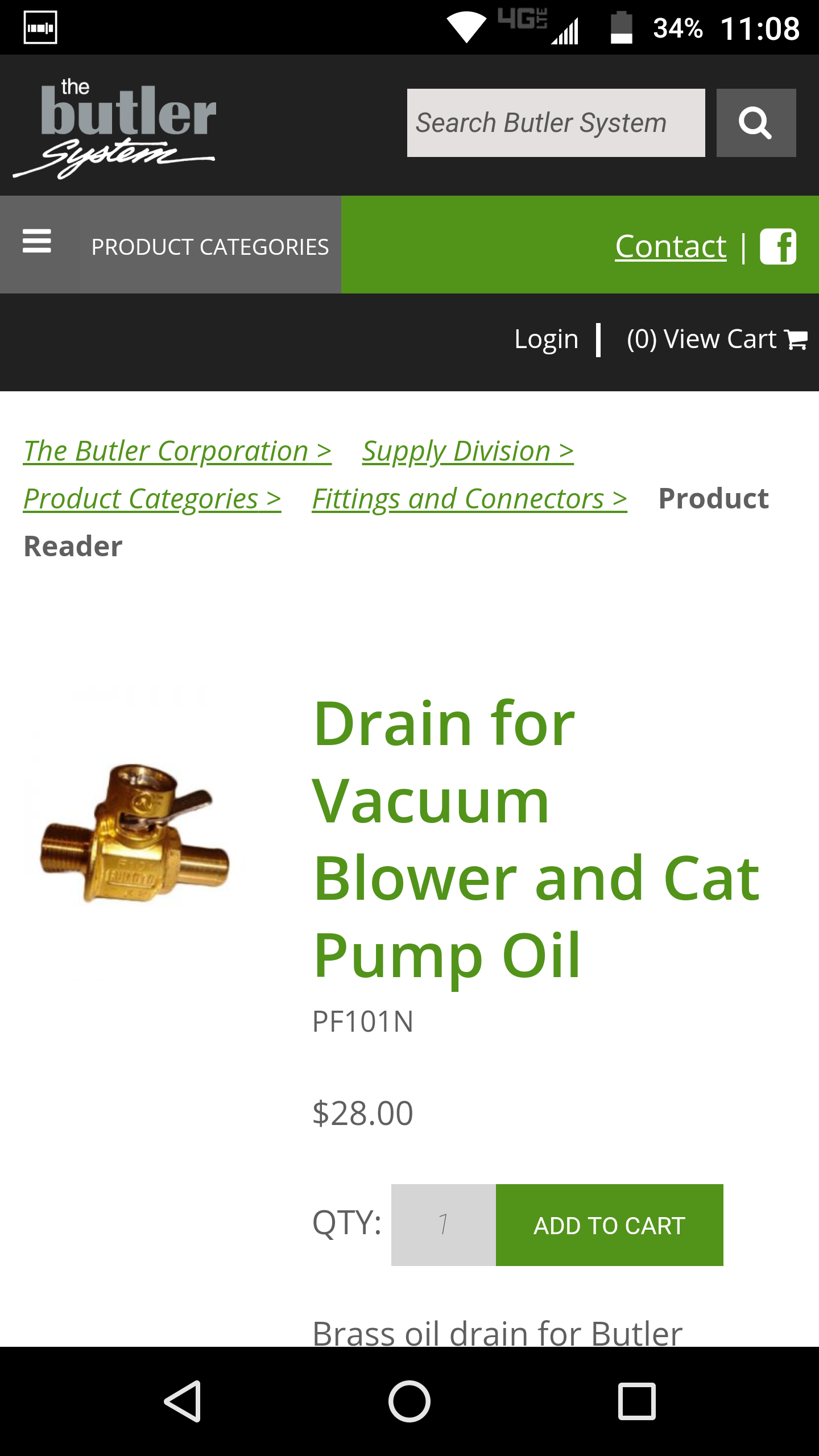

I would strongly encourage all who use this quick valve to install a plug at the end Hose attached to this drain valve. Always fill oil including hose to level, yes I know go ahead and waste a little oil it will be cheaper.

I've heard of several inadvertent draining incidents that killed blowers or pumps.
I seriously think the draining issue is not needed very often, if at all.

I agree. We are not talking internal combustion engines where the oil gets contaminated. I usually put synthetic blower oil in them and never touch them for 5-6000 hours except to check the glass sight gauges for proper oil level.
