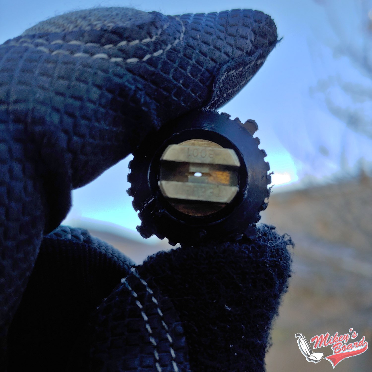

Anyone got a way to clear a Jet in the field?
I'm getting faster at it but wondering what techniques you all use?

That's what I do. Be careful not to break it off in the jet.use a plier and yank a wire from your carding brush. Use the wire to clear the blockage. Or for bigger jets keep a bunch of the bread bag twist ties, strip the paper back and use those. PS. poking anything into the jets may widen the holes and distort the spray pattern.
I carry the little fold up pack in the top of the plumbing box.welders cleaning tips
what size jets you running? can get a small welders tip down a 1.5 and aboveI’ve got welding tips
Even the smallest is too big
You idiots
He was asking about an 8001. Marty's right, the welding tip cleaners are too big.what size jets you running? can get a small welders tip down a 1.5 and above
You’re a huge helpTake it off and blow thru it and tap it on something so the particle will fall out.
If the jet was completely round, it would. I have 3 or 4 welders tip cleaners kicking around and I can clean a 8015 with the smallest one but not a 11015 because of the angle of the holeA # 6 welder's tip should fit right in a # 1 jet
