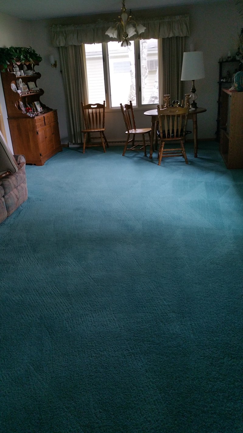

Didn't even see this easter egg amongst all the other gems until well into cleaning.
Spent 20 minutes blotting, but still just coming. Must have been right down to the pad.
How do you guys get rid of something like this short of a repair?
This was the best room of the lot. Customer happy, but I was not completely.
BTW, this was done with Rotovac Oxy-Enzyme Powder.
