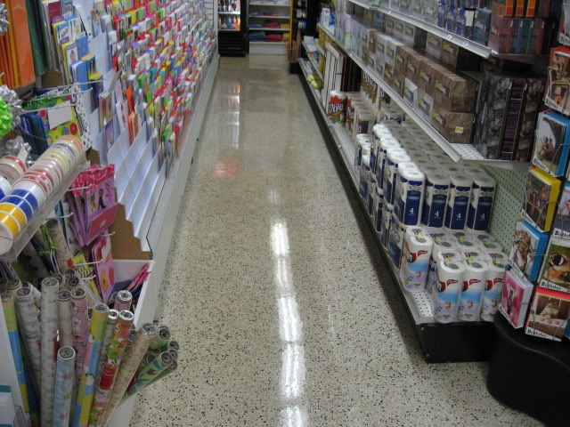

Here is a 50 year old terrazzo floor we maintain. You can see a color differentiation to the right of the aisle where the shelves were moved over. The lighter color is where the floor was not exposed to light for YEARS. I think this floor at this point had 2 coats of terraglaze and 3 or 4 coats of ishine.
