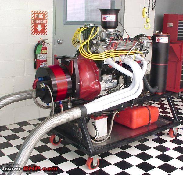

BHP is the engine torque measured under brake
(no other way to measure a stationary engine)
HP used to be measured in theory only (no engine friction a perfect system) which was why it was standardised.. sometime ago...
@bob vawter might know?
This is how they test BHP ? Make senses.

Yeah i was referring to any load or resistant involved is considered brake power. Only engine dynamo testing can truly test bhp.
Fortunately for us, the benchmarks for these equipments has already been established, and easy to find if anyone wants to upgrade, replace or build their own TM. 23hp kohler is more than enough to run 45 blower and pump while generating enough heat to do the job. Such as the 370. But they have a very efficient heat exchanger system tho.. so i rather just buy one than build one.
