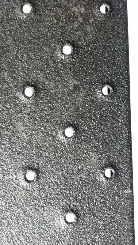

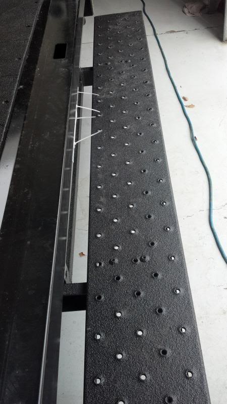

We also did the bumper on our newest box truck. The guys said for $100.00 he will spray the others and I think I'm going to have them do it. Had a guy slip off the bumper with wet shoes and hit his head on the hand rail last month. Probably wouldn't have had happened had it been coated. I might also have then spray our aluminum ramps, they get very slick when wet.
