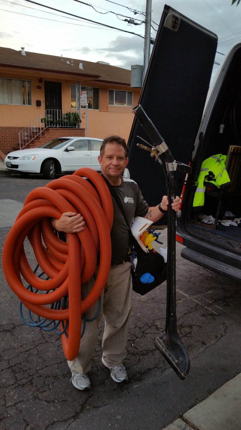

I take in the Vac hose and Solution hose in one arm and the wand in other hand and my "Baby Bag" strapped over the shoulder. my "baby bag" has: all spotters, blocks, tabs, towels, booties, Ph tester, and skidders. Corner guards are laid on top of the baby bag and held under my arm. I don't bring in my hydro force at this time because I may have to adjust the formula based on what I am cleaning. I will be carry all this stuff into the house upon my 1st encounter/entrance in to the home. Ill tell the customer to take me to the farthest part of the home we will be cleaning and drop the items in the appropriate place in that room. I will then do the "walk through" with the custy..
6,972
San Francisco, CA.
Papa, you meet them at the front door with all that in hand?
Yes.. I believe It subliminally tells the customer-- I'm ready to work-- now get out of my way. haha.
I might leave the stuff in the entry way-- It depends If I know the customer and the layout of the home. I then do the walk through where we handle the questions and concerns.

Here's a photo of how I show up at the door.
San Francisco, CA
Wow. Papa's adorable.
Had I carried all that like him, I'd have left a trail of destruction behind me throughout the house, on my way in. Pops must have taken classic ballet lessons.
I always take the solution and vacuum hoses together. It's a 'no brainer' they're attached :winky:
Man you are a pack mule! ;)
It would certainly cut down on trips but I'd agree with Ofer I'd break more than my fair share of contents. I'm a bit of a bull in a china shop already, we don't need to make it worse for me. :winky:
