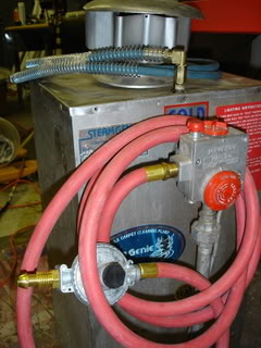

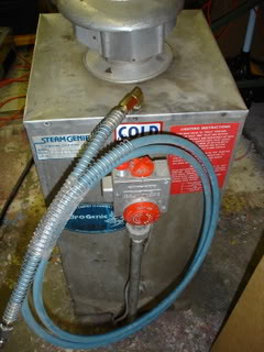

Scott S.
Feb 3, 2008
3,250
PA
Scott
I was sent some pics from a good friend.. this is how its supposed to look.. dont ask i know nothing about the LG heaters yet..
Thanks guys..
