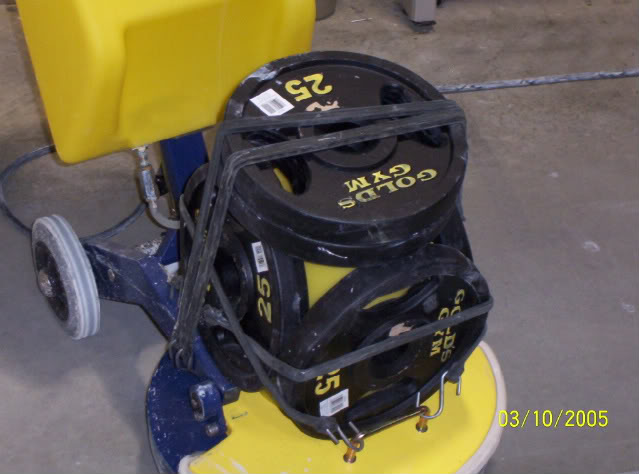

here is my set up for doing stone or concrete

I tried put 100 lbs on the cc cimex when I had it. Funny, that thing just kept going.

hey if no one is around screw it...and yes it worked very well....extra 125 lbs.....worked like a charm
