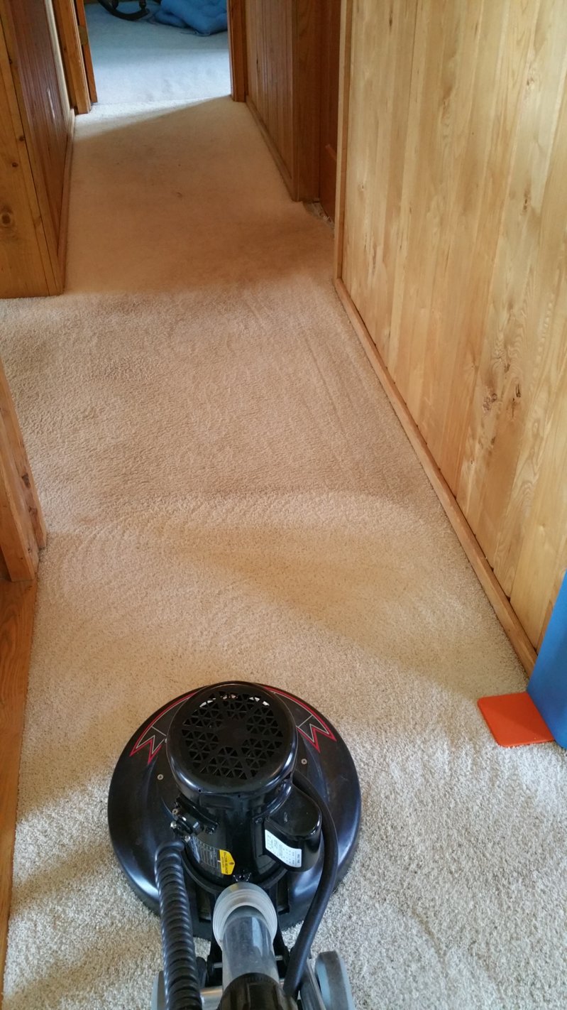

Which works better on commercial cimex or orbital.
gene
The Cimex is able to cover a little more square feet per hour than an Orbital. But an Orbital has more versatility because it can be used for bonnet/pad cleaning in addition to straight encap cleaning. Plus the Vario is lighter and a little more nimble to toss around, so it's great for getting in and out of smaller jobs. But if I were tackling mid sized commercial jobs or larger commercial jobs - the Cimex would be what I would go for. So it all comes down to the type of job you're doing.
