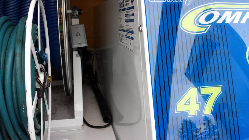

Cleanco TM's don't really make a heavy recovery tank.
I set this one up to run at 14"Hg. The 6" clutch can't take 15 but apparently the recovery tank is only capable of handling 13. Tuned it back down.

Ron;
I would talk to Lou @ Cleanco . .
and show him the pictures of the tank.
We operate @ 17" on our reinforced tanks.
Larry

talked to Lorne at Cleanco. Tanks are apparently made of 3/16's Aluminum. Clutches are not meant for anything over 14"Hg. He said with the hose capped off to set the vac relief for 13" :eekk: So they have a Roots 4.7 blower and only run them to 13". Sure miss my CanAm

Is this Cleanco yours now? I don't see what's wrong in the picture...
Never mind, I was looking at the fresh water tank...

my cleanco developed a split in the same exact location. Also straight down below that hidden by fresh water tank. Not enough cross support.
Had it welded but the welds split open again from the tank flexing. Currently gooped and taped over to stop leaking.
