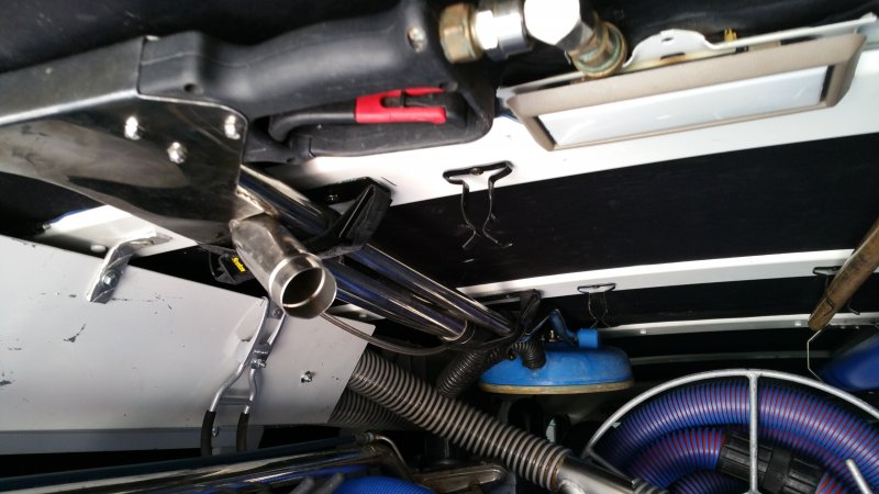

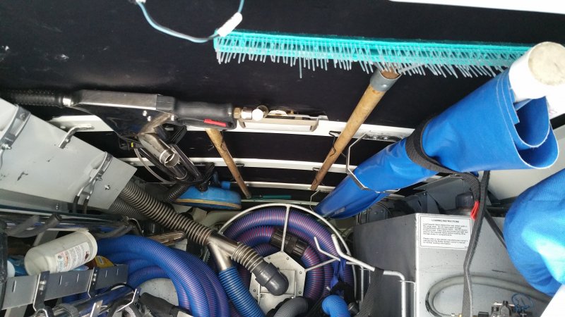

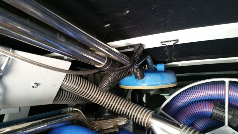

To the Roof that is!

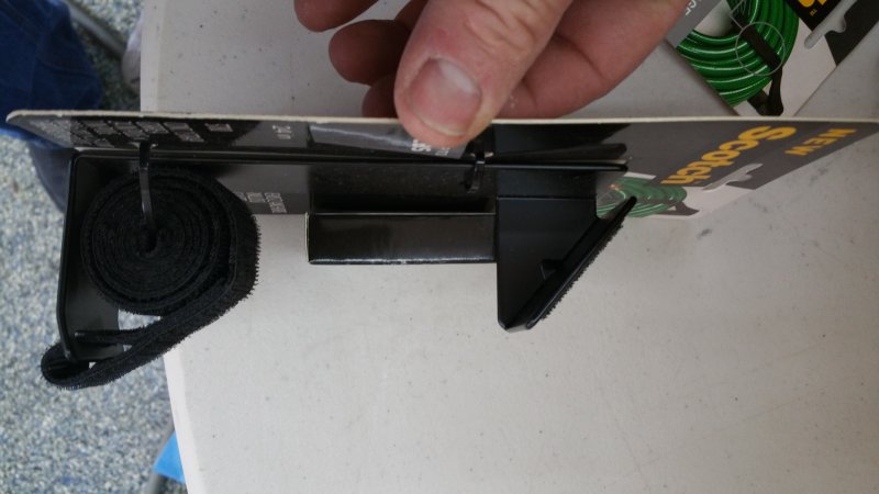

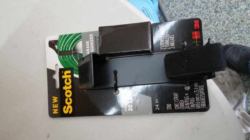

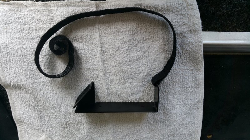

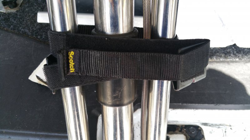

Found these little gems at Home Depot....but didn't buy 4 at the time because wasn't sure if they would work....
They work great! But Home Depot only had one more and wasted a good part of the day trying to find some more....so ordered more from Amazon
Scotch Garage Organizers
They have metal to them, and also Velcro strap....

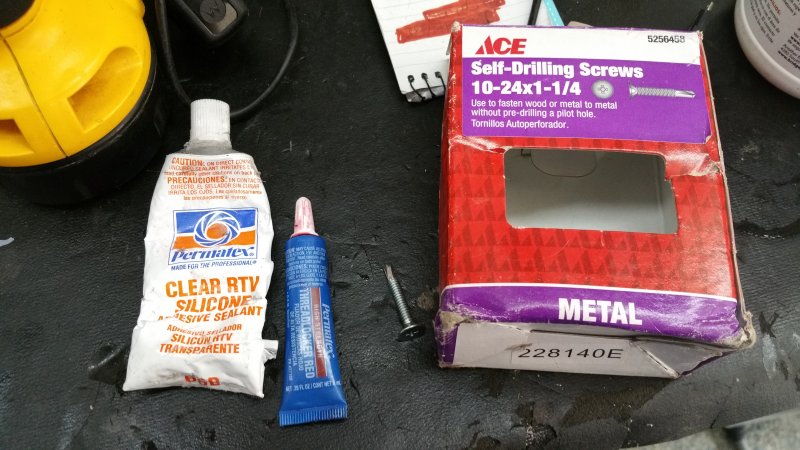

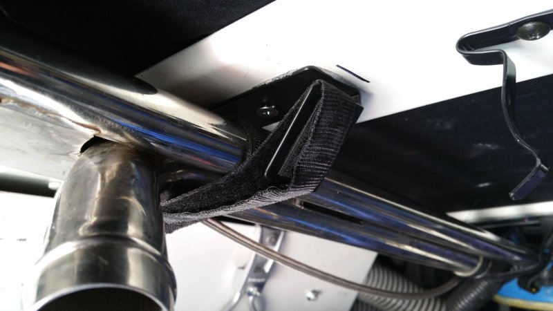

I used Clear RTV silicone to help secure to the roof with self tapping screws...and put Loctite on the screws....Hate squeaks and the RTV silicone helps hold in place, and eliminate metal to metal squeaks.

These were on my GMC vans, but I would check the screw length as mentioned just to make sure safe, and 3/4 to 1 inch might work also...the 3/4 inch I had of this type just were going to be too short....but I measured on the side of the beam, plus I have extra material and plating with the Butler insulation package on mine.

Mark, how is your Spinner hanger working out? I'm hoping to do this soon, too.
11,200
Great! I meant to ask if it is easy to get in and out?
So far....except a person still has to crawl into the van....LOL....
I Need to make an inside roof system tray that slides right out to me from the back....and electric :winky:
Oh and remote controlled...and an app for that :biggrin:
