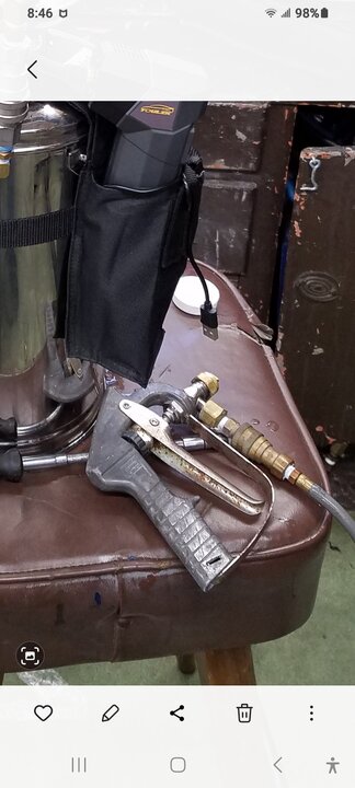

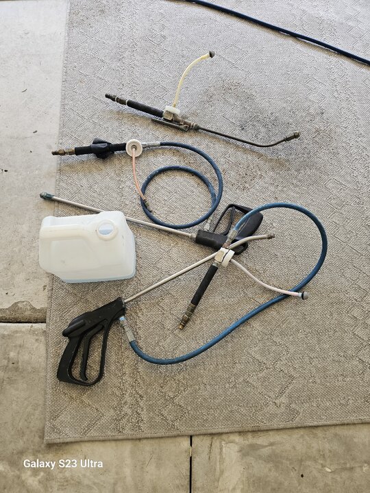

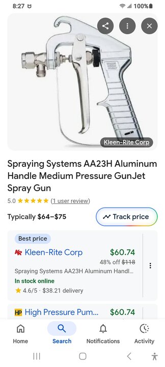

I hate all those plastic guns i went to the metal guns that came on the original hydroforce models when they first came out. They're made by spraying systems and last a very long time without any maintenance or problems for those of you whos business plan is to make 250k per year on a 1,500 investment, perhaps these are not for you. But anybody looking for a quality product this might be it . Wands are sold separately and come in 20,24 or 30" curved or straight they ues tee jets and the wand will also hold a ball check and unlike some of the guns and wands available this one is comfortable in your hand. I also use um on my upholstery sprayer. I prefer the 30" curved and i straightened it out a bit to fit me ergonomically

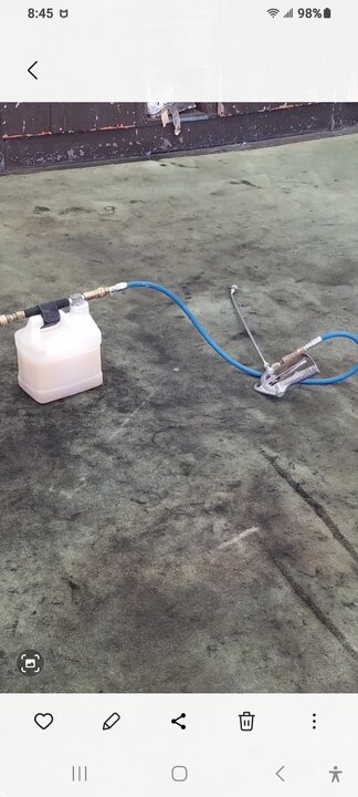

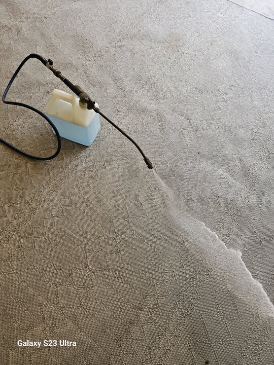

You swing that whole jug around??? My wrist and shoulder hurts just thinking about it. Tahe an old male& female quick connect. Use a punch or big ass nail and a hammer to Knock the guts outa them so there a hole straight thru mount female on the hydraforce and the male on a 3 or 4 ft hose mount your wand on the other end and quit playin around........ your welcome

Ball valve baby just hope it doesn't get to hot
That was my bane days. Nothing got to hot lol.
I buy bulk ball valves and QDs. It only takes a few minutes to replace them on the job. Same for trigger valves.
I need the tax deductions anyway.
