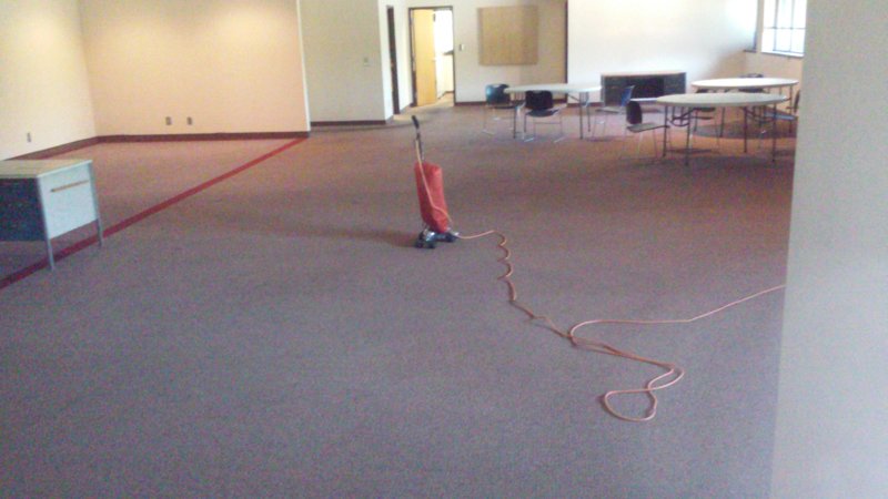

I just wore my ass out yesterday on a huge commercial conference room yesterday that was 2500sq ft. I would've had a better, less labor, if I was able to use my 15" wand. I had to use my 11"prochem quad on all that carpet because the floor was on concrete and it was wavy. My big wand kept going over the waves, losing connection which wasn't extracting all the water. So I had to use my smaller wand to keep it connected to the carpet.
Now, how do you zipper guys overcome that? Isn't the zipper 15" or do they make a smaller one for these situations? It would've been perfect for a zipper if it's able to extract all the heavy water

Hard to tell in the picture of course how bad the concrete is, but there are sometimes that I have had incredibly bad concrete that I had to Zipper from different angles or use a wand on part of the job....
