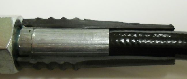

I have deemed the cause of the premature failure of my Parker Parflex hose to be:

The heat shrunk vinyl heat sleeves / bend restrictors retaining too much heat.
I believe Greenie was right. I got about 7 years on the hose I got from him with the wire bend restrictors that allow the hose to breathe. Actually the hose did not fail. About 10' back I finally rubbed a spot in the hose right around where it would always catch under a door or something.
Yesterday I removed all the heat sleeves on the parflex hose and under the sleeves every end was ballooned apart from the excess heat being trapped.

We use a strain relief that fits tightly on the crimp, but loosely on the hose itself for better cooling.
We use lots of ParFlex and have not seen the ballooning that you noticed (other than wear).
Of course 230 is max rated temp, so we use 50' of blue wire-braid for temp spikes.
Not on the parker hose you sold me.
The sleeves are heat shrunk so tight to the hose you cannot pull them back till you get the hose real hot.
As for wear, there is no wear under the sleeve.
Larry Cobb
5,795
Larry Cobb
Those were the original Parker strain reliefs.
We recently changed strain reliefs to a new model that fits looser on the hose,
but still fit tight on the crimp.

We changed because we thought it was a better strain relief.
Better cooling was a secondary benefit.
