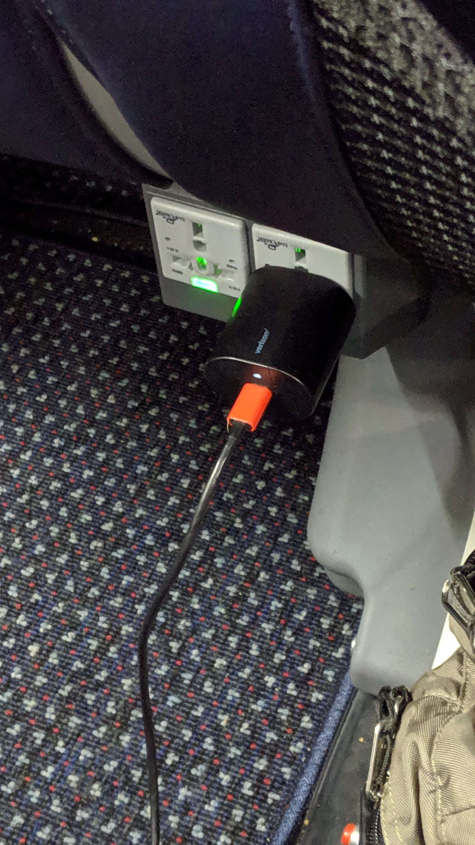

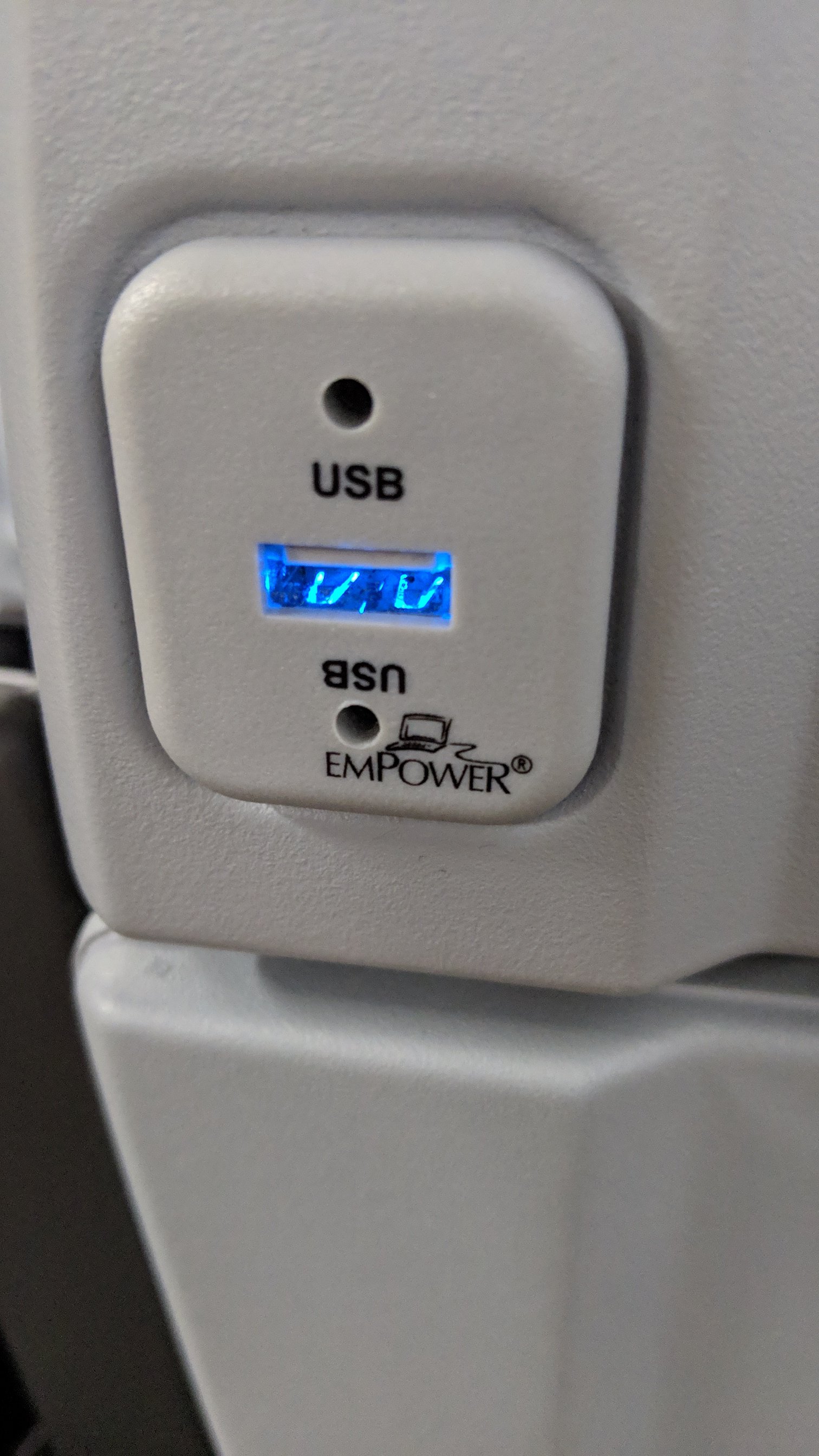

I got to reserve the exit row and just look at these bonus features that the $30 per checked bag gets one on American...
