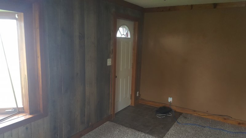

Rented home not supposed to have been allowed to smoke in...

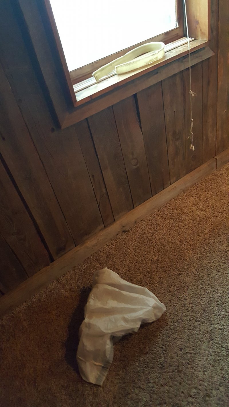

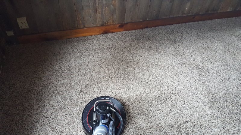

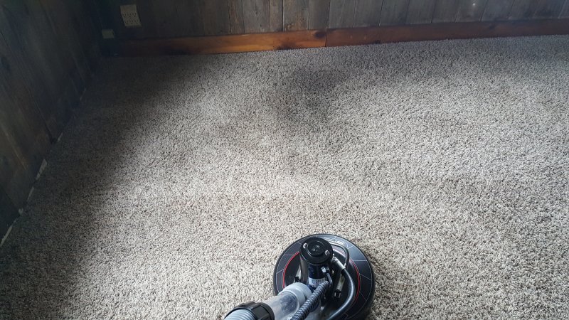

Well....no promises but with the reclaimed old wood ...all open grain....gave it a shot.....
Worked very well....4 hours later on return, smoke odor way knocked down...product still working. Didn't want to have to seal the wood....
They might have to still Seal and Paint the walls with Zinsser Bin Primer sealer...and repaint. Also duct work should be cleaned. I took care of the fogging and carpet cleaning.
They are happy....I'm Happy :)

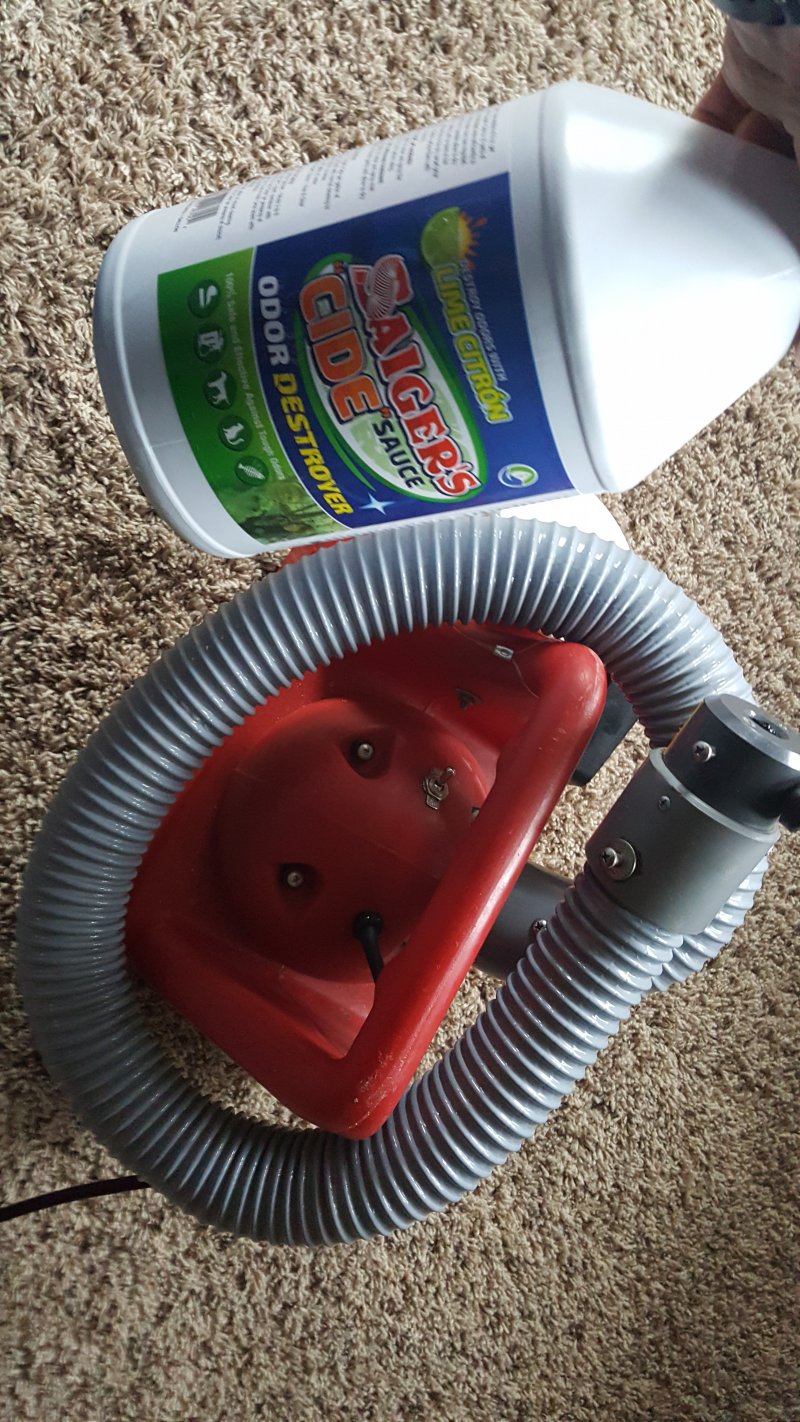

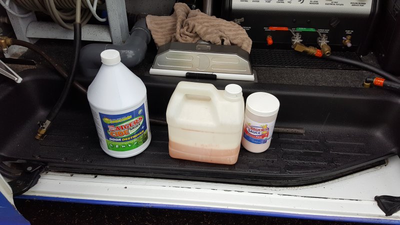

What mixture did you use in the ULV fogger ??
And how was the final outcome ?
I put in eight ounces per gallon for this treatment and when I went back that evening it was much better and they were happy.
But I would like to go check it again today.
I am just waiting for an opportunity for them to be home to do that. There is so much that needs to be done in this house.
I kind of felt like I was putting perfume on a pig.
If I would have had more time to do this job properly I would have done things differently. It really needed more cleaning before an odor treatment in my opinion such as wiping down more items cleaning ductwork...
I do want to get in there though and see how it is doing

I got a chance to check out the place today.
Cigarette odor gone at this time...
I really want to say we got lucky... So many variables... Just really happy this worked...
Now to see about a man and a horse... Well their horse trailer living quarters anyway... Lol
11,199
Grand Rapids, MN
Women of the house just called too...
They cannot smell cigarette smoke either...but are going to paint the ceilings they said due to some staining....
But otherwise....Home Run....Happy clients...invoice paid...:rockon:
