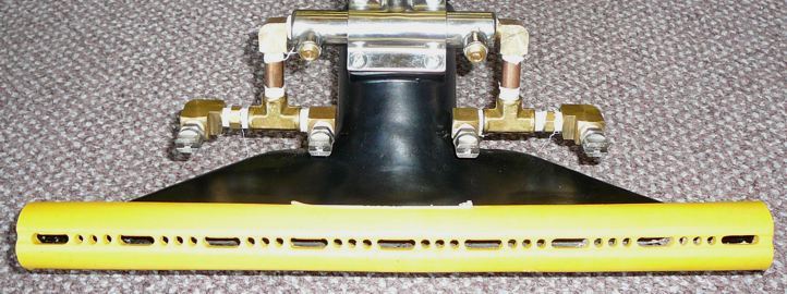

Psi?
Trying my zip with flex tomorrow...
sent via tapatalk.
550 psi, make sure when you start that the back glide is at it's proper height. If you adjust it with your machine on you'll know it's good when you hear it suck down. Erik probably has it set up already.

I just bought my 2nd zipper. They are well made. It edges/vacuums vey well against the wall. I like the sight tube. I cleaned Titan Freight Systems the other day. Nylon carpet with diesel soot in the carpet. We have to pull the chairs mats so you can see the dirt lines pretty well. clean evry 6 months.
Usually have to prespray and scrub but the just did a redline prespray and soap free rinse, slow rinse and dry stroke. Perfect.
I even became an emulisfer hack at Anna's Bridal. Did an 8' X 50' section, did another about the same size then started my 3rd area, the first area was about dry when I was done with the 3rd area
If you think about it, you are vacuuming up your prespray and dirt before you rinse then you rinse and dual chamber vacuum with a dry stroke. That is vacuumimng the same area 4 times

from my experience so far with the zipper
it kicks the every living crap out of the prochem titanium
no question, no comparison
and yes, I just said that'
of course tight areas or light soiling a wand is just fine but so far im getting away with zero pre scrubbing

I wouldnt want anything bigger than the 15. When cleaning commercial carpets the wider the wand the better chance your going to have a break in suction because of uneven surfaces.
