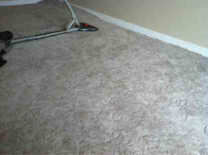

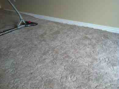

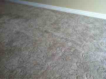

I've said this before, but I used to never offer to take these type of wrinkles out because I didn't want to drag out the power stretcher.
With the Tri force, I can grab it, an awl, stair tool and a knife and have this gone in 5 minutes. This house had two rooms like this:
An easy extra $50 on top of the cleaning. Customers will gladly pay to have the wrinkles gone.

I cannot tell from the pictures, but are those furniture indentations that you are removing from the carpet?

I like the look of the tool but rather than stretching from the middle both ways on a room with ripples on both sides I'd rather stretch it one direction with my power stretcher.
Trim one wall and be done.

Depends on placement of floor vents, closets, doorways, transitions, and existing seams.
Just charge enough, and then you can like it.
I agree, but there are a lot of situations that the wrinkle is close to one wall. It's easy to knock out and you don't have to move a bunch of furniture.
