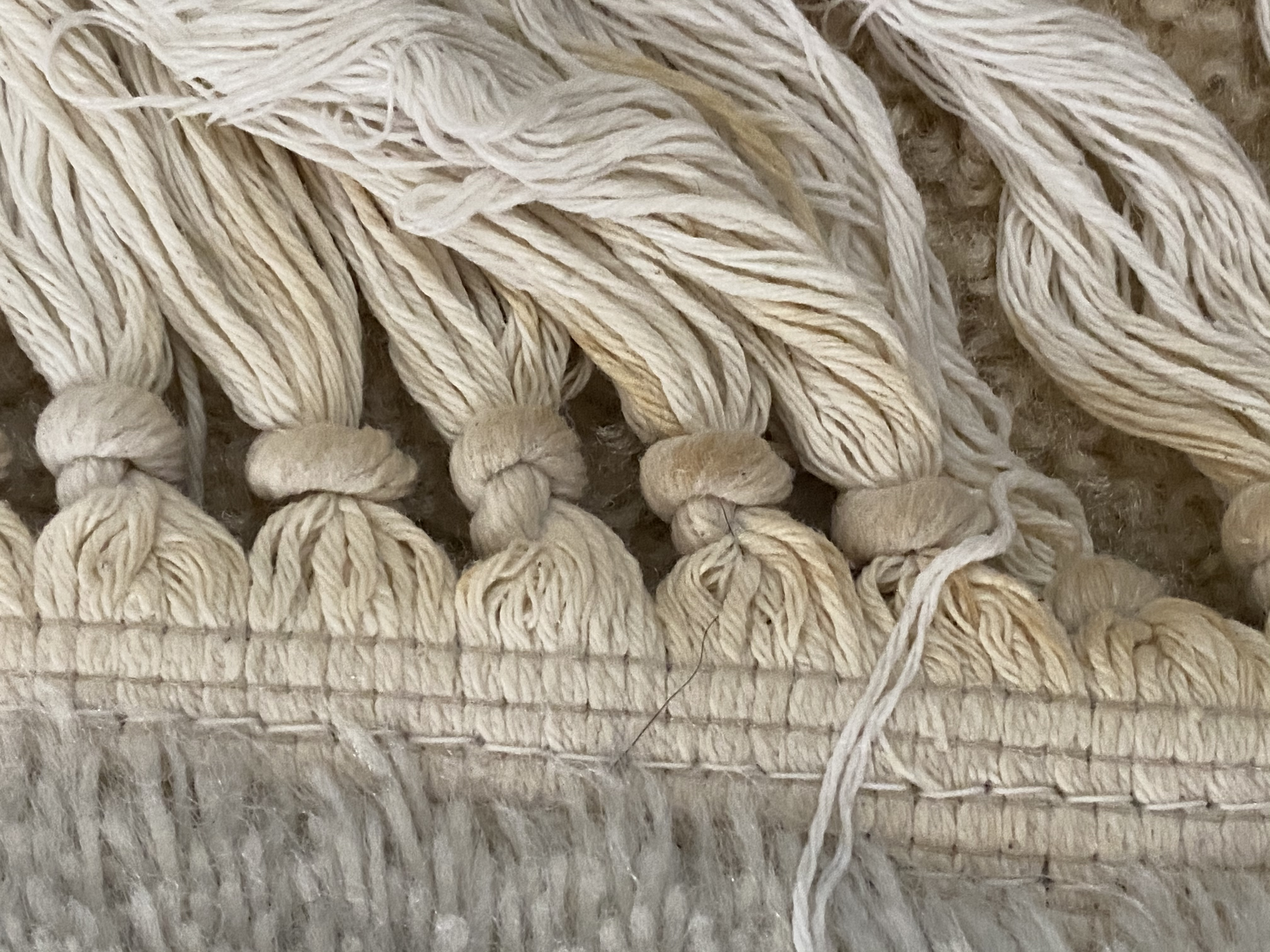

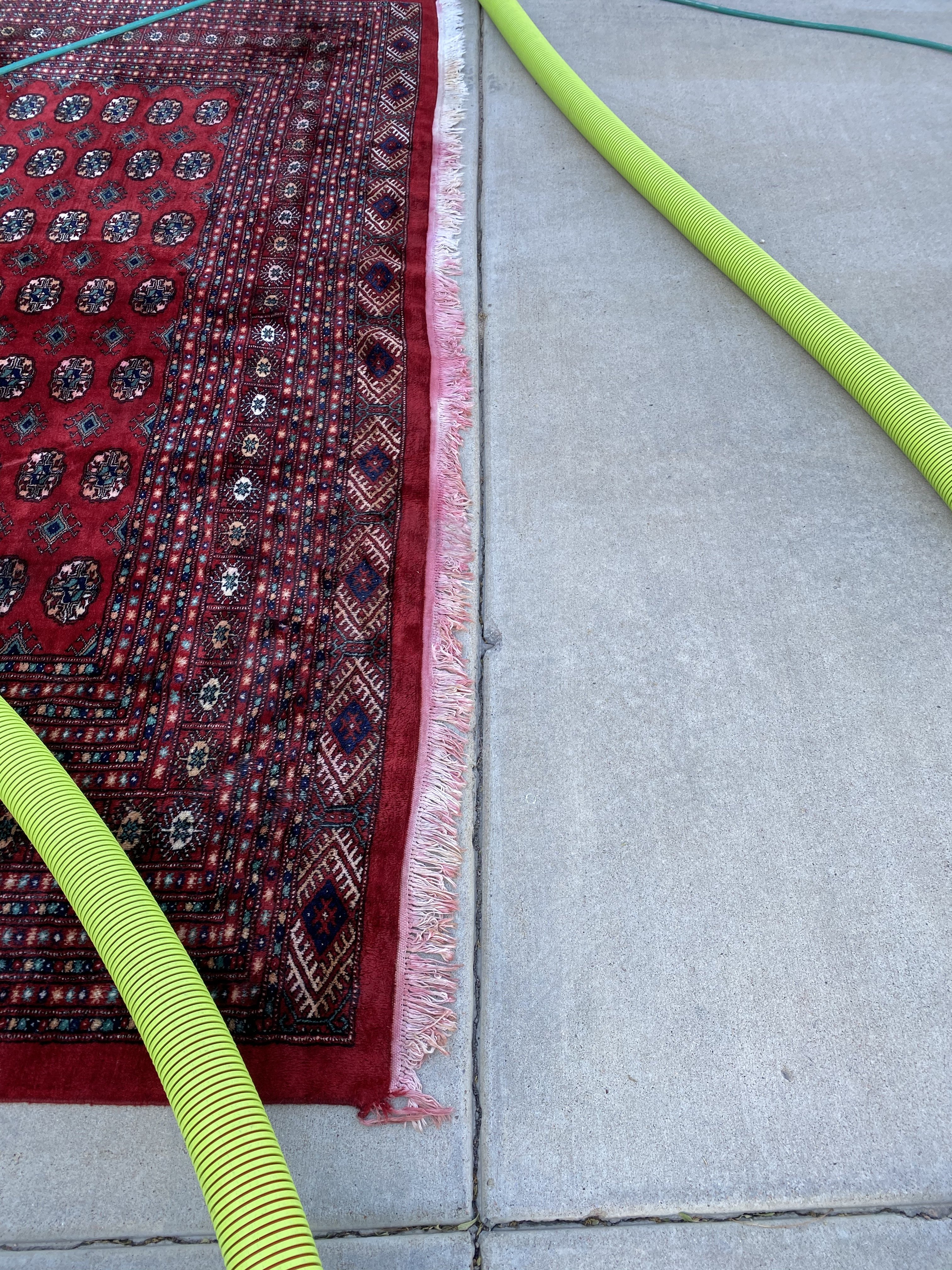

Browning of fringe
23,524
Redding
Did you pit wash it or try and clean it with your wand?
That was pit washed. I ended up soaking it with acid rinse and drying it face down on a canvas tarp. I placed air movers on the back in an effort to reverse the wicking. It worked. I also sprayed the backing with peroxide as a post treatment which cleared it up more.

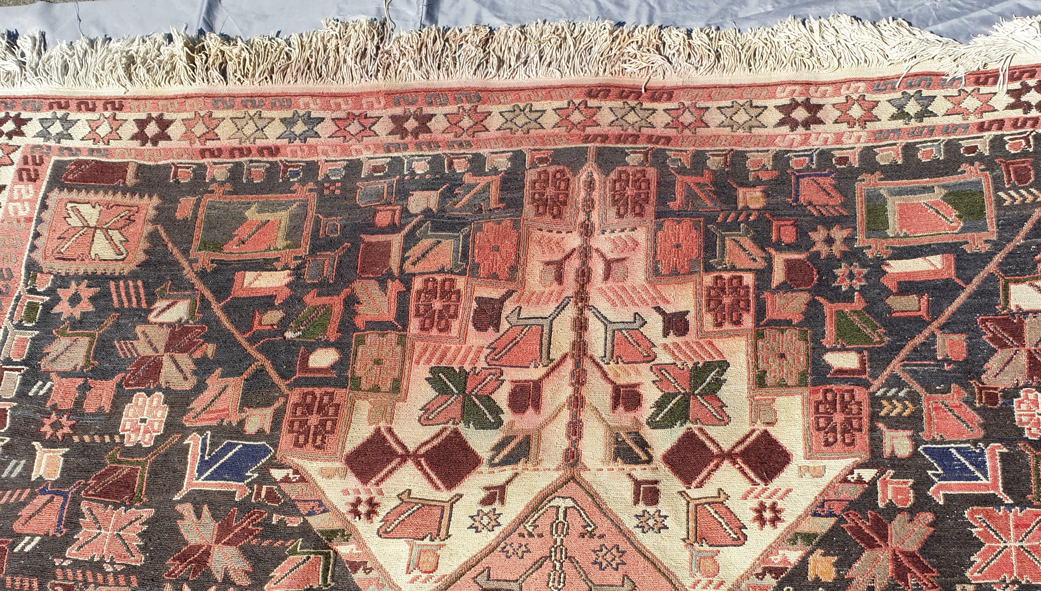

Here is a bleeder for you... the after is going to cost you.
They stored it in the basement and the faucet broke because of freezing and then they dragged it up the white steps. I got the rug looking like new the steps did not turn out as well.

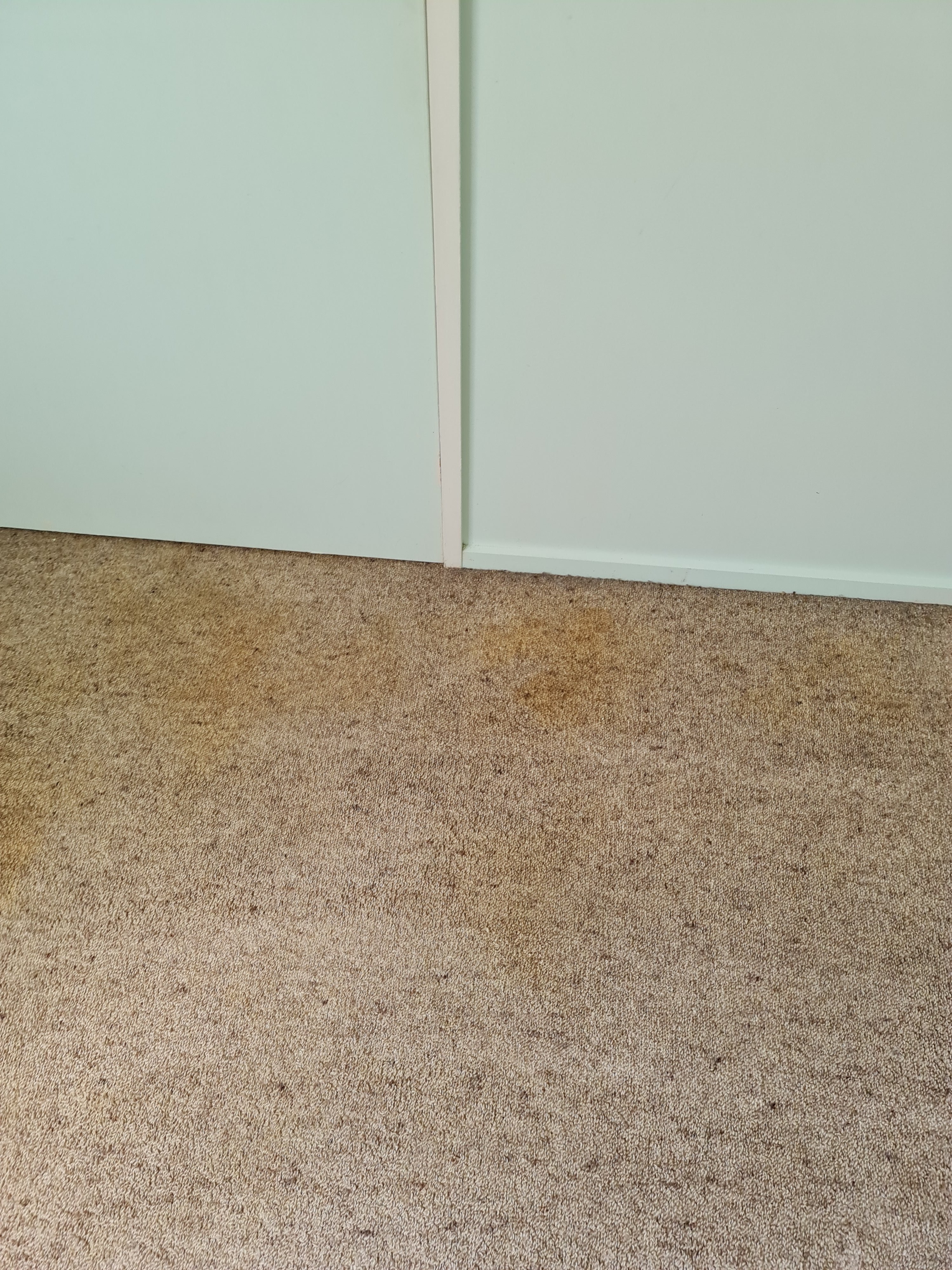

What about browning from lignin?
112,580
Browning;
Cellulosic browning occurs when plant-based rug fibers dry slowly. Sugars in the plant cells rise to the surface and leave a yellow to brown discoloration. The process is similar to an apple slice or wilted salad greens turning brown, and is easily corrected with the proper cleaning methods. Sometimes confused with soil wicking.
Rug types that are prone to Browning should be cleaned in a Rug Washing facility, please consult your IICRC certified rug technician for assistance.
Browning;
Cellulosic browning occurs when plant-based rug fibers dry slowly. Sugars or Lignin in the plant fiber’s (Jute or Cotton) cells rise to the surface and leave a yellow to brown discoloration. The process is similar to an apple slice or wilted salad greens turning brown, and is easily corrected with the proper cleaning methods. Sometimes confused with soil wicking.

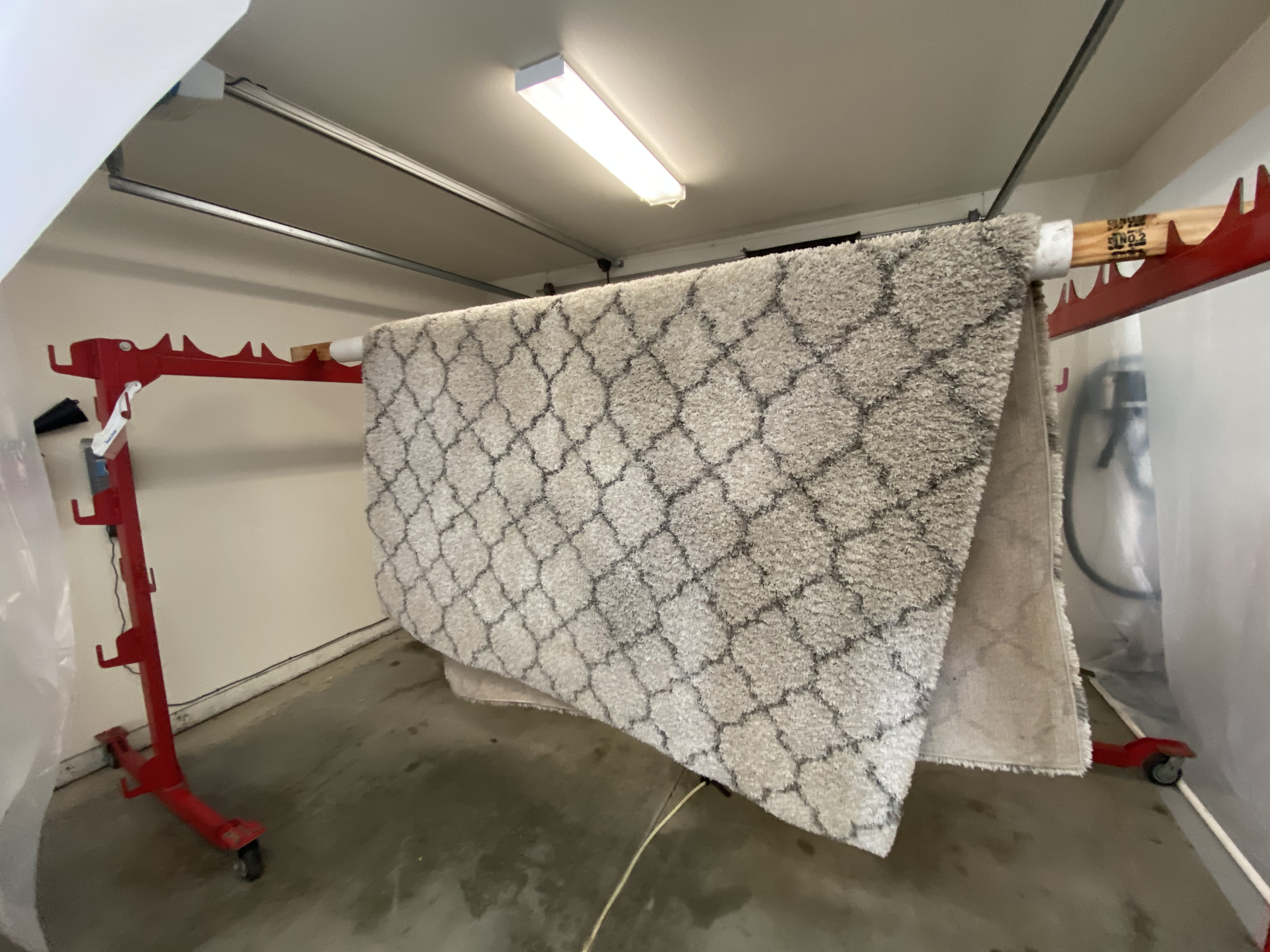

Got the monster done today, and 5 others...
The big one is taking up 4 bars.
I think I’m going to need another hr. or 2 on it....
I’ve got 10 more that need to be done. They are all scheduled to be returned this coming week.
Boo, guess I’m working 7 this week.....

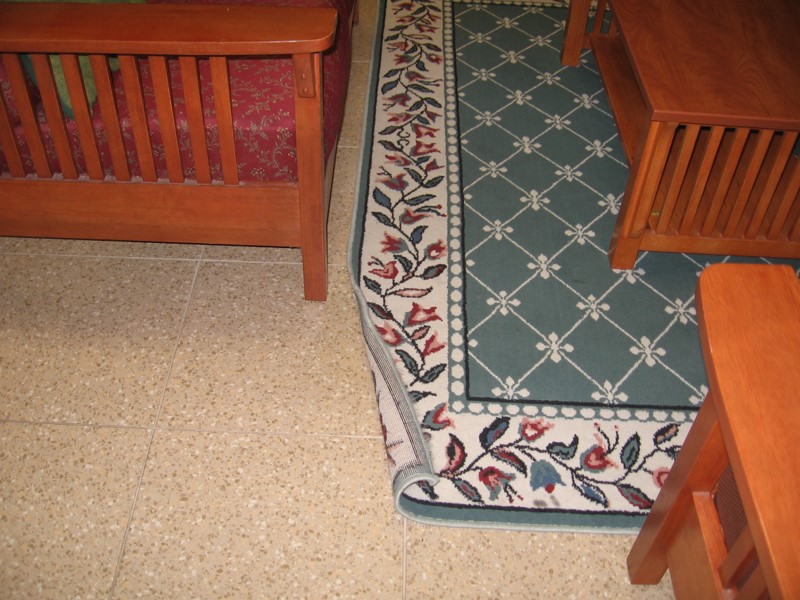

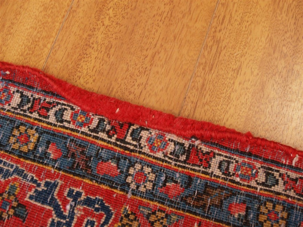

The picture you have is what I'd call ripples. The cure is blocking, so I'm not sure those procedures will be helpful.
The edge curl that rug cleaners see is more like this: (rug is upside down)
or this:
The first is caused by uneven tension (weft is too tight) that might be temporarily fixed using a steamer/iron. The second is from people dragging their feet and might be temporarily fixed by rolling backward.

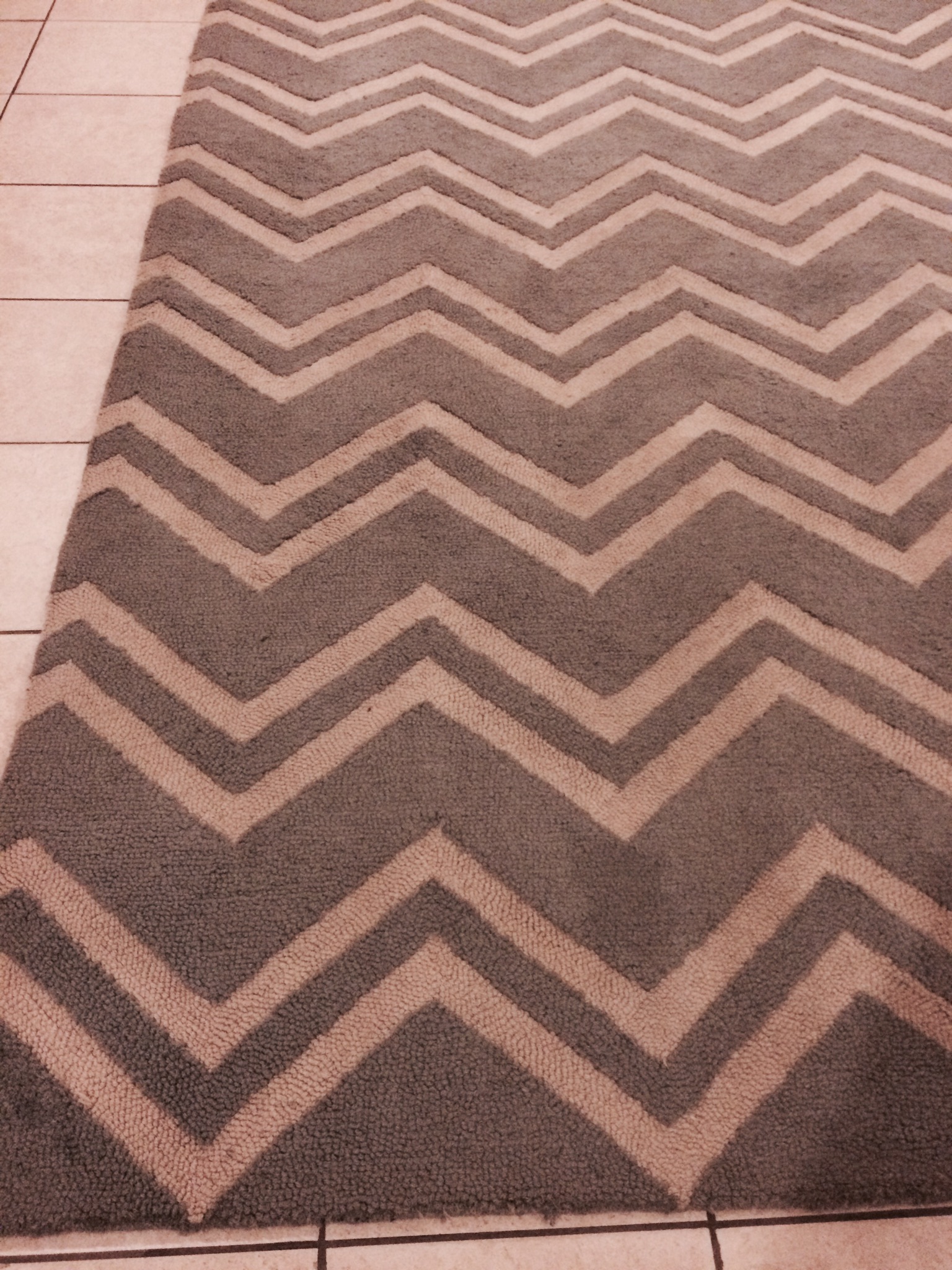

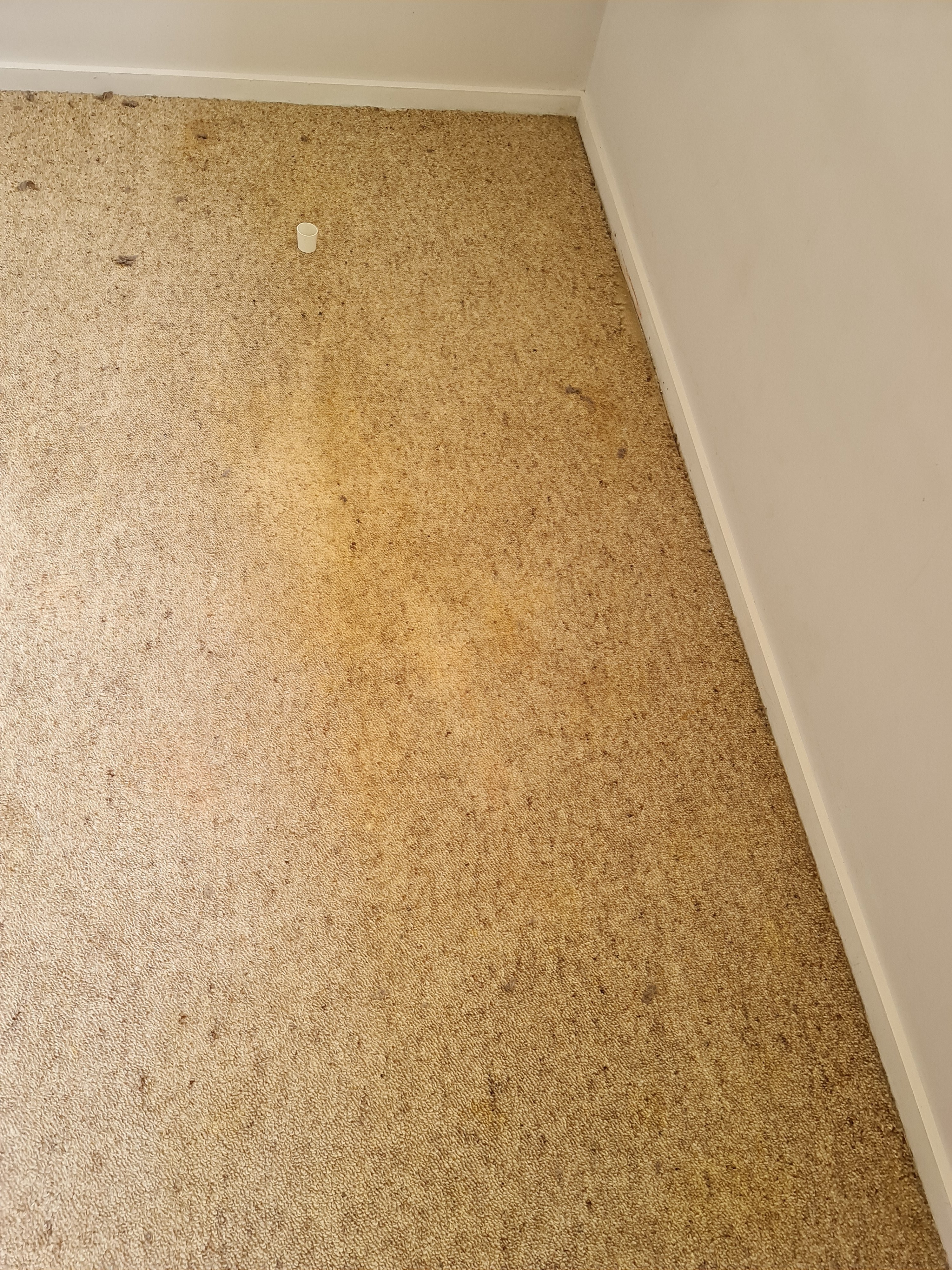

A wool rug that browned from alkaline washing, corrected with an acid rinse:
Not being critical Coastie, just looks like the floor has a similar browning issue. Maybe part of the first photo is a lighting or camera artifact?
Heart of Dixie
No, the floor is a beige pattern tile. I guess we can thank iPhone or different lighting on different days for the way it changes tone between pictures.
