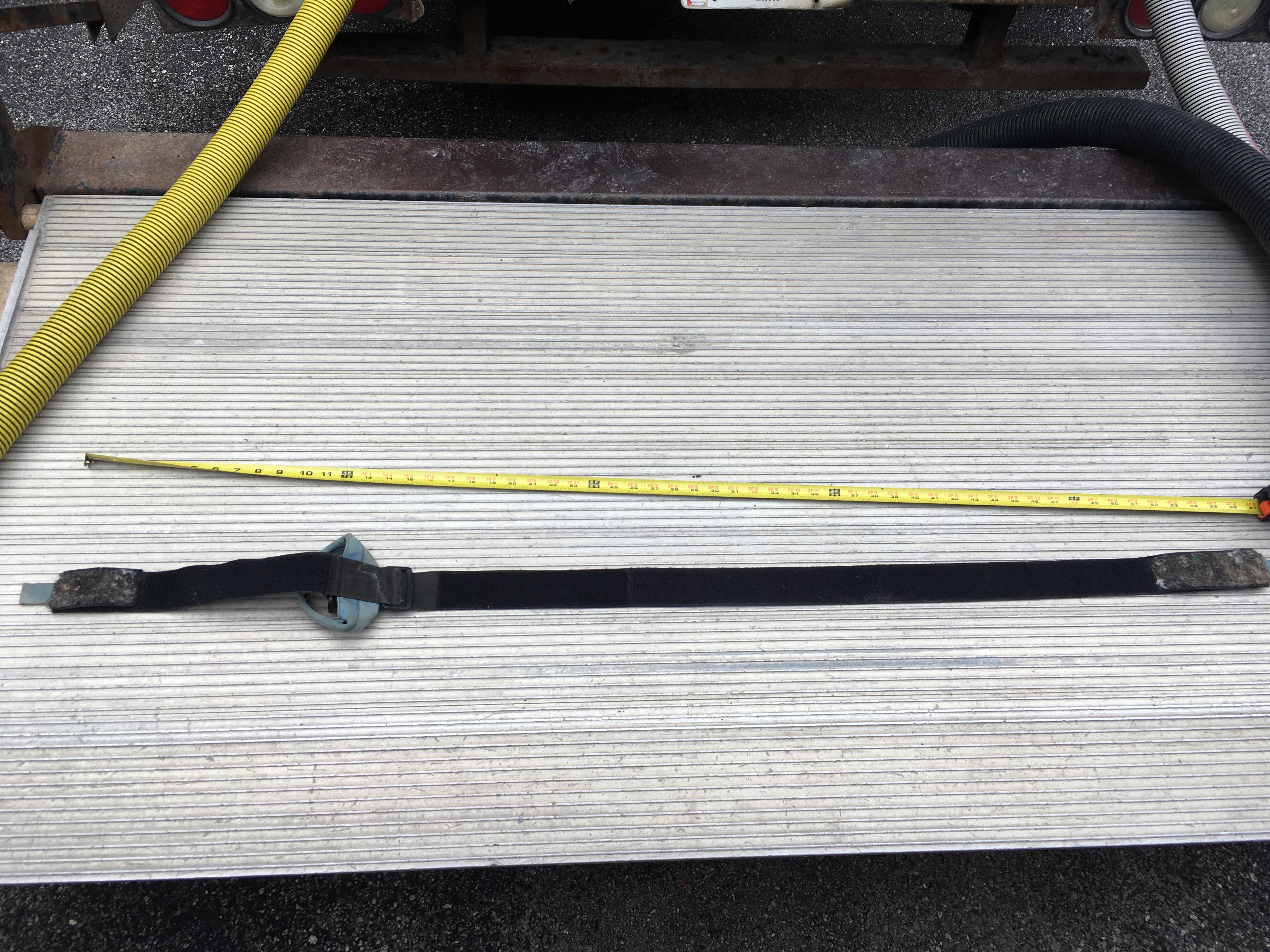

My hose strap is on its last leg. I wonder if Greenie has a box of these laying around. Love these fooking things.

My brother's upholstery shop make these for me from time to time. Ask around locally.

I just remove the old hook and loop and sew on new hook n loop. don't use the stick on kind. The glue isn't strong enough.
Or use wire brush to remove lint from hook and run a lighter to singe/melt the loop just a little. Eventually it will need to be replaced.
