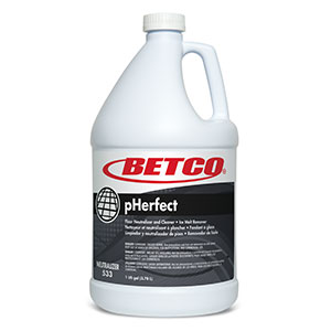

11,200
We are working on something new right now also especially with the salt we run into up here....
But, this has also been a go to in past few years...
Still some Salt just is aweful and very difficult to break up and flush out.
Agitation and pressure seem to help, but we have some places that just get trashed and the salt turns into rock again.
http://www.betco.com/products/pherfect/53304
Reactions: Russ T.

Oh, and Scott being Scott gave you a great detailed direction to follow. I just simplified it is all and gave you the one product that will absolutely without fail get rid of it so you can still use 601 and follow his directions and you will for sure not have any wick backs following step by step what he wrote :)

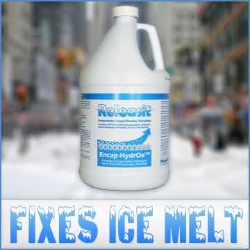

I've got some entry mats and a decent size walk off area that the local supermarket wants me to clean during the Winter. This area catches a lot of ice melt from the parking lot. I've experience that ugly, white mess that appears when dry. Is it that easy? Just acid rinse?
Sounds like the entry mats could be pretty hammered with an ice melt build-up. You could pre-spray with any of the acid based products mentioned above. And then rinse like crazy! A heavy amount of flushing can help unload the build-up of snow, ice, slush, water, dirt, oil, and concentration of sodium chloride.
Final step: You could also run back over the entry with a post-encap using Encap-HydrOx following the rinse step. Getting aggressive with an acid based formula should do the trick. Encap-HydrOx is extremely acidic (pH 3.5 in concentrate) and the hydrogen peroxide adds a kick too.
If you need help shoot me a message.
