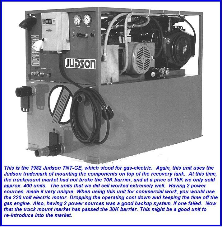

The next option for an electric system is to do what we did in the early ‘80s with the TNT/GE. This unit consists of a 5 HP 220 electric motor. 5 HP is the most HP you can obtain and not go over the 30 amp limit. This system also incorporated a gas engine. When using the system on 220 it incorporated a lot of different adaptors so you could plug in to a dryer, oven, or restaurant 220 food bar island. If there was a problem not obtaining power, you could always use the gas engine.

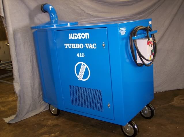

I posted about this a waaayyys back... but I see this as the future of carpet cleaning..
Big trucks will probably never go 100% electric because the power they demand for heavy loads and the battery configuration needed even with high tech cell technology, will be so heavy that they use up the valuable capacity of the trucks.
However there are already diesel electric trucks on the market in many cities that utilize complete electric motors much like the trains, to drive the vehicle. They eliminate the transmission and they have instant torque through all speeds. The diesel engine is hooked up to a generator which supplies as much electrical capacity as you would need.
When these trucks and vans become the standard. We'll be able to see truckmounts like Judson's using postive displacement blowers ran off electric motors that use power from the diesel electric plant on board the truck.

What is the largest PD blower one could operate with a 5hp elec. motor?
dgardner
Apr 7, 2008
5,109
Dan Gardner
Driven to full output, I'd say about a 32.
