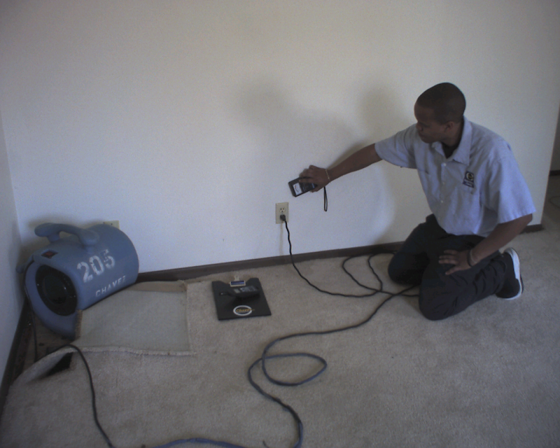

Steven have you see the non destructive meter that has the electrode pad on an extension pole coming back to the meter? It allows you to stay on the floor and off a ladder. Looks like it would be excellent for commercial work. I saw it in a magazine but it's at home. I'll try to remember to bring it tomorrow and scan it.
I made this for the up coming Home Shows, it will be 11x17 on foam core and standup back.

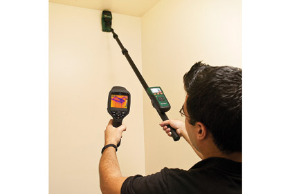

I like the Extech i5. John has a really good price on it. http://www.superiorcleaningsolutions.com/servlet/the-478/CARPET-CLEANING-EQUIPMENT-TRUCKMOUNT/Detail
Also would recommend each lead have one of these I like the tech kits because it allows accountability for the techs. Each tool has it place in the case so less chance of an expensive meter getting left at a job site. http://www.superiorcleaningsolutions.com/servlet/the-1229/CARPET-CLEANING-EQUIPMENT-TRUCKMOUNT/Detail
ok so forgive the stupid question but it seems with this camera i wouldnt need really any other moisture meters because this shows you if you are wet or dry period?
am i dreaming and hoping or on the right track?

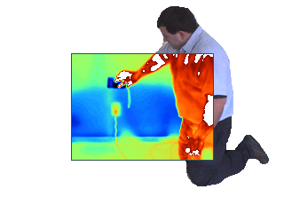

Thermal Image (IR) cameras read temperature differential, so while it shows up as a different color you still need to confirm it with the other two meters. Where it helps you is when it comes down from one level to the next, it's not always obvious unless there is a stain. It also helps on larger projects when you have multiple rooms or commercial where you have large sq/ft affected.
It directs you you confirm it and then you don't have to slide the nondestructive along all the wall space or probe everything. They are time savers, money makers in that they help sell the job by showing the true scope of what is affected. You can also look much more professional than your competitor that doesn't own one.

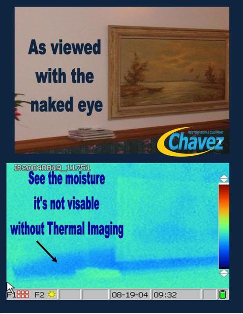

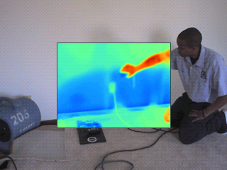

Dave - The thermal imaging camera will show temperature differences. A cooler area MAY be the presence of water, but not necessarily true. For example, look around door and window frames its normally cooler there than other areas. Also where the ceiling meets the wall it typically will too because of poor insulation.
The thermal imaging camera helps with the guess work of where water may be, but you should always confirm your finding with other tools, such as non-intrusive moisture meters, hammer probes, electrodes, ect ect.
When you get your handy man service off the ground, you can use it to find poor insulation jobs, and can use it to easily sell insulation removal and replacement. Or possibly replacement of windows and door if you're going to go that far. I've done that in the past and called it a "Home Energy Audit".
When dealing with mold - the imaging camera can give you a good clue and see "into" walls where a leaking pipe may be if the source isn't known. It sure beats going around an entire room on your knees with a moisture meter hitting a bunch of dry spots.

See how without it we wouldn't even know to look there. Yet with the camera Greg is able to go right to it to check with the nondestructive and he can stick his pins down near the baseboard line or completely remove some base and check with longer probes to see if the insulation is wet in the wall cavity.
