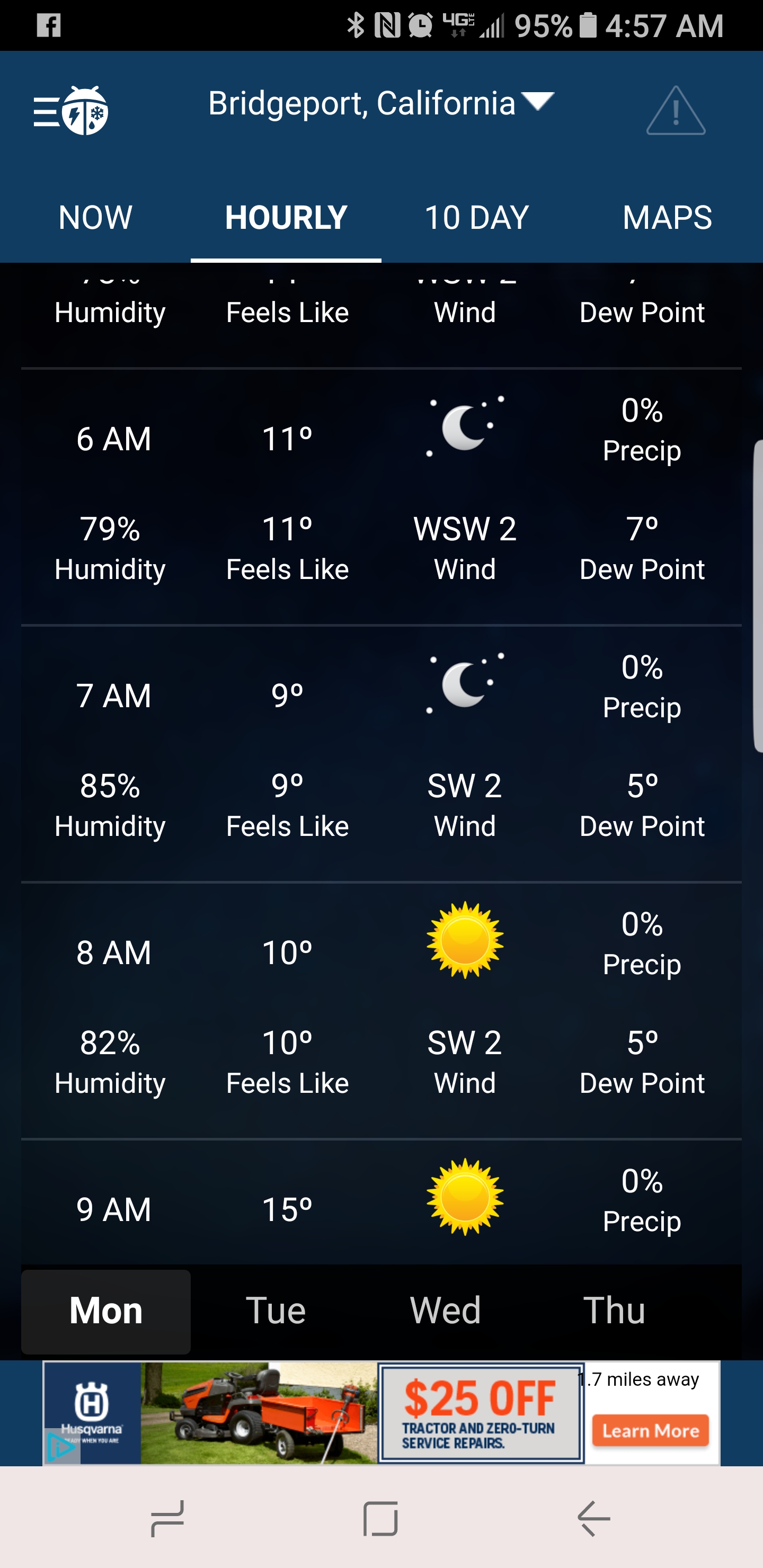

Starting at 7 am today...
Andy
Feb 5, 2016
970
Doesn't Matter
today you will wish you had a water tank. The supply hose is going to freeze unless you can keep the water moving. You need to watch some of @Mark Saiger videos on cold weather cleaning.
