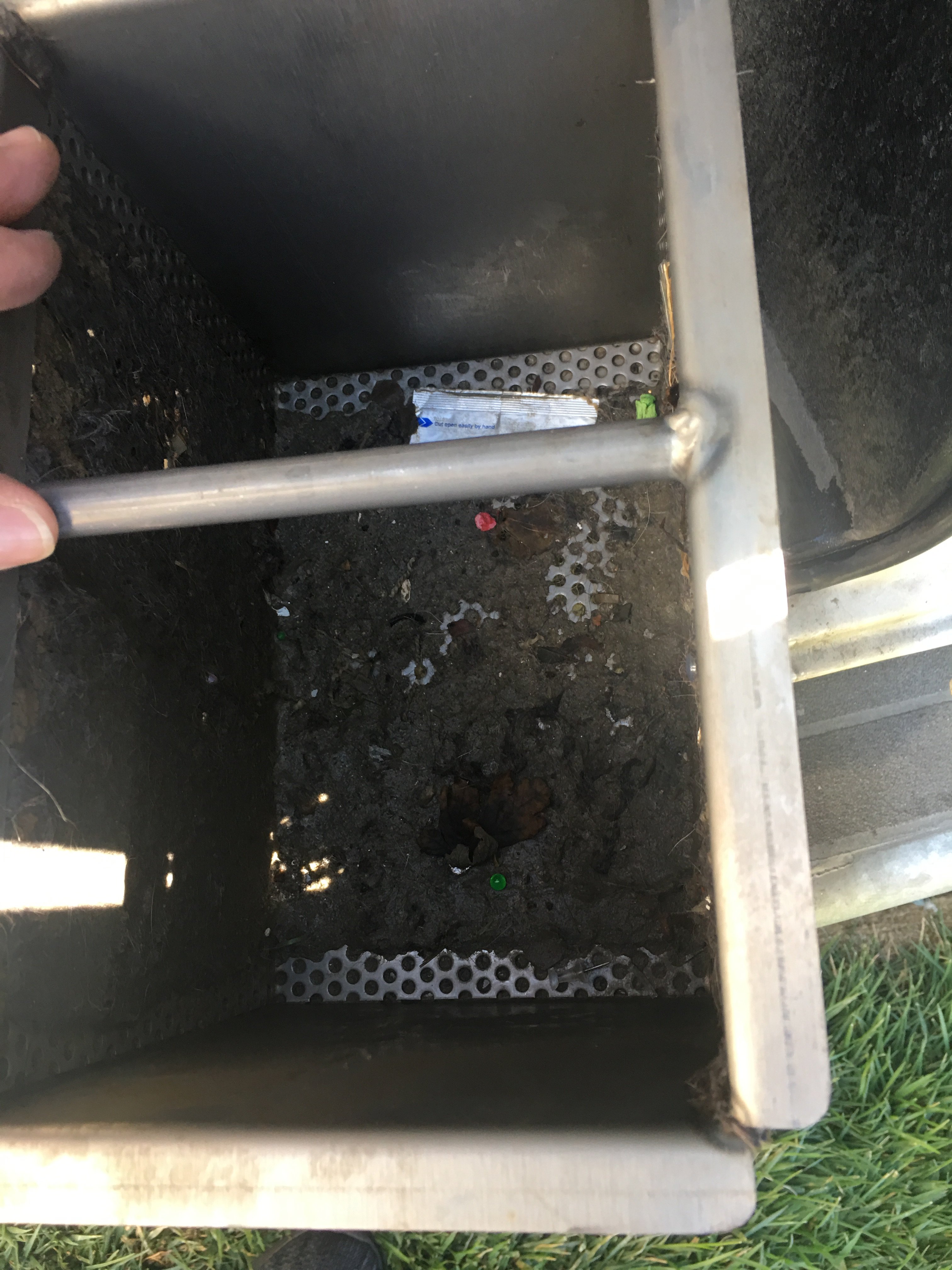

I teach my guys to use the Devastator and use the dust downer and replace the paint filter.
I even show them the filter basket in the waste tank and the blower filters to wash those down.
Sent Phil this today!
The blower filters wouldn’t let light pass through either.
For that matter the Devastator was full and the waste tank stinks!

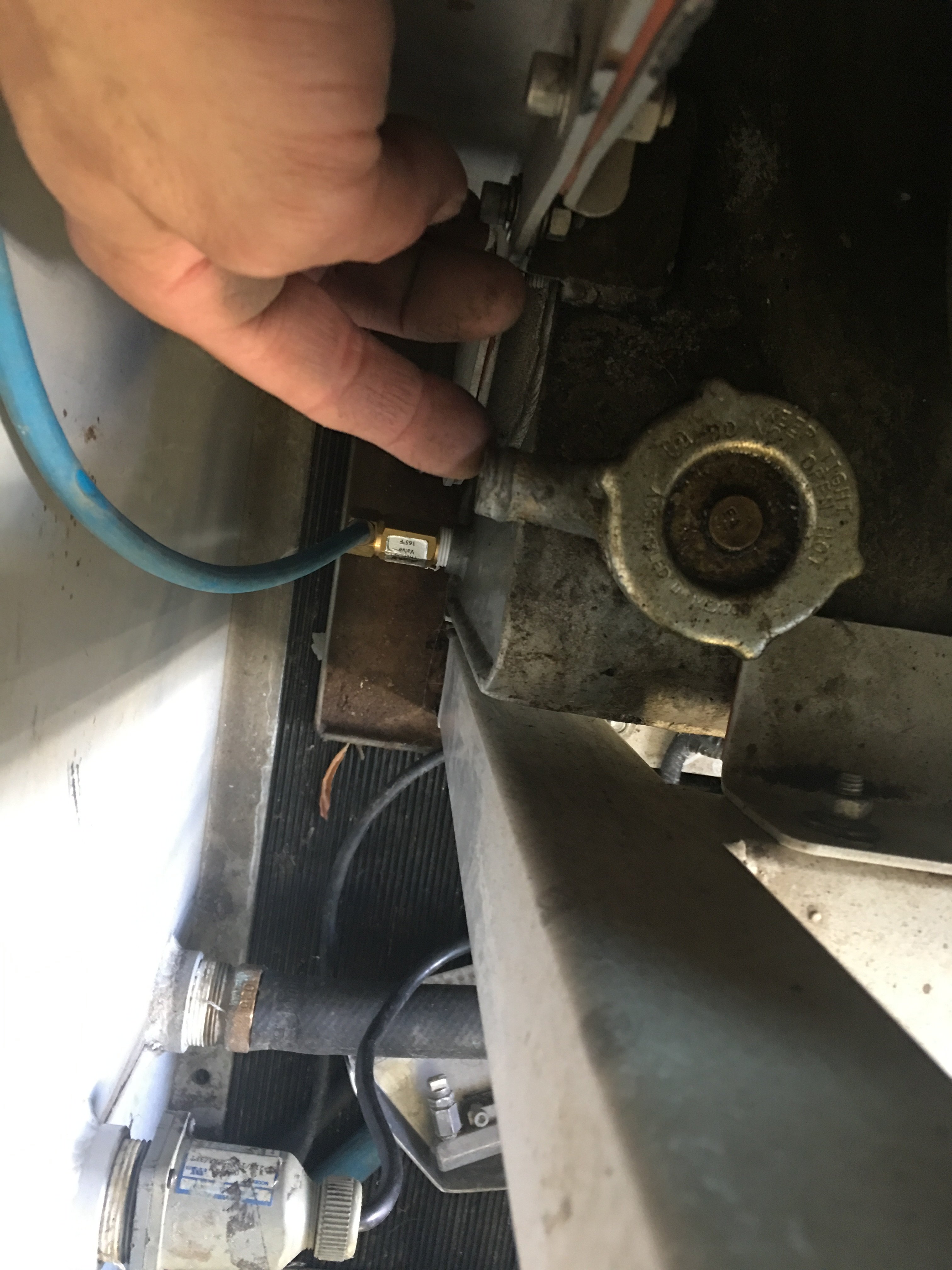

This is a shot of my 570 water box radiator,
When I had the machine reinstalled in this van, my guy didn’t attach the breather hose so now if there a spike in pressure my van will flood!

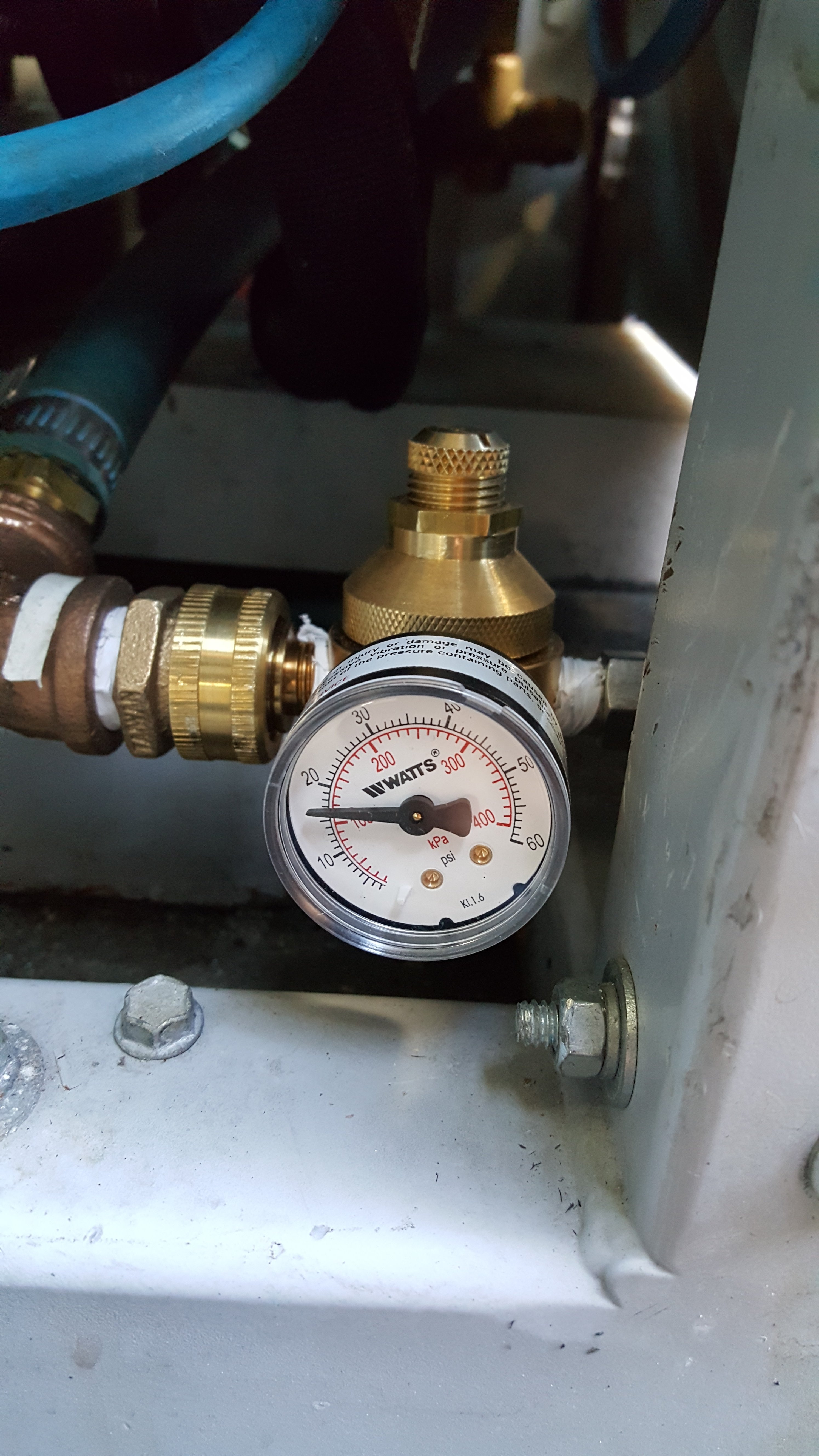

I did buy this sets the water pressure to 25 psi and haven’t had any problems.
Still I’m sending the photo to
My guy and asking him what’s up?

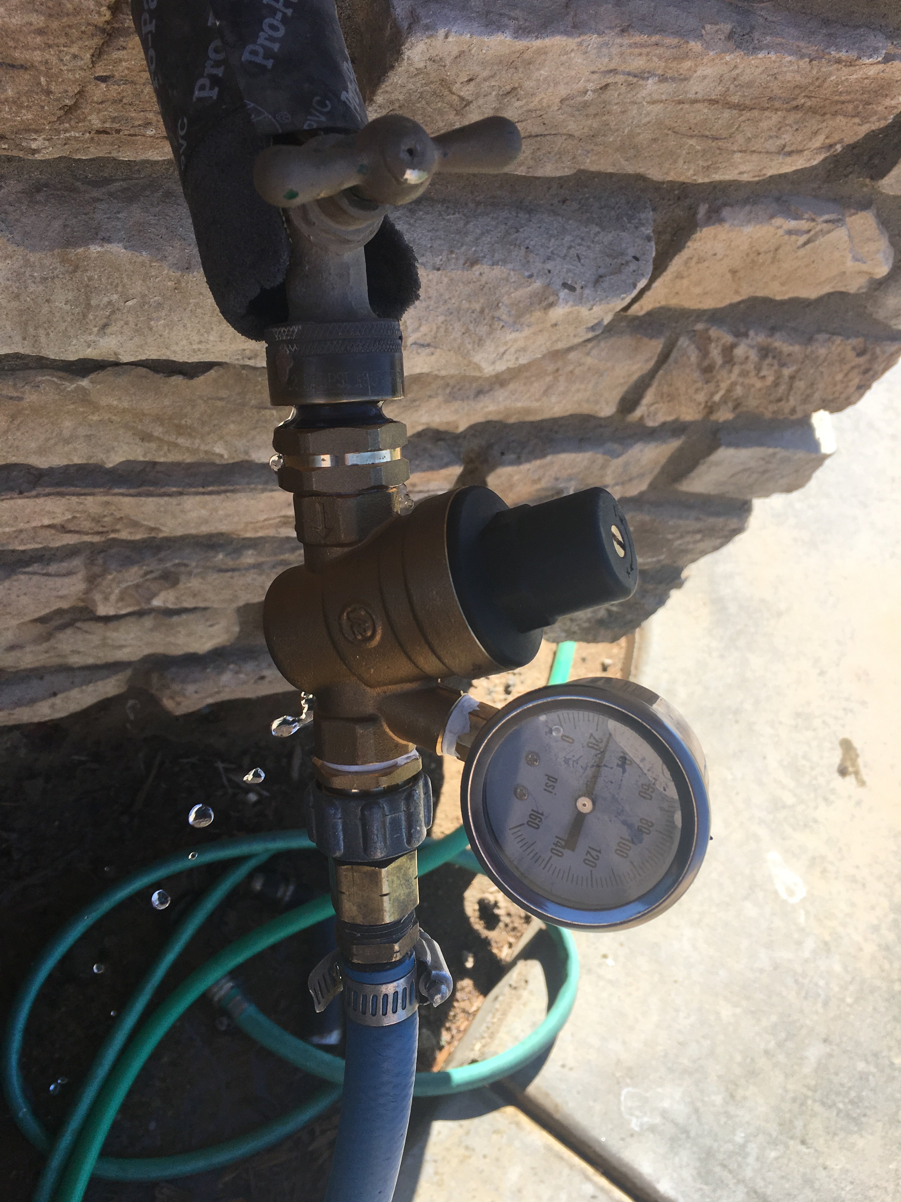

watts regulator...is the best one that I have found..that's what I put on my 570 and it has been trouble free ever since..mine is set at 17....
go to Walmart in the RV section and get one of there water filters and put it in line somewhere before the softener..it will help it quite a bit and keep all the crap out of the regulator..replace every other month..it will be the best 20 bucks you ever spent...these regulators are very temperamental and it only takes a small grain to screw it up.....
