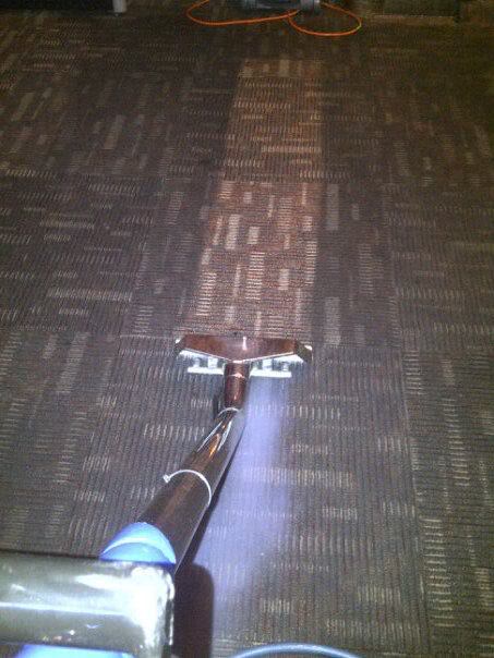

I'm agreeing with Scott here. Even with the best installation, the tiles do have very small openings between the tiles in which water will find and enter. And the solid backing doesn't allow for airflow. You could do some extreme airmoving, but you better have a way to vent the moisture out of the building. I have carpet tiles in my dining/living area, and have HWE'd them many times because of the pissin' dog I have. I have tried many different approaches to cleaning and drying them with HWE, and they still take 10 hours or more to dry. I've tried ultra low pressure, many dry strokes, glided ti and quad wands, glided RX20, and air moving, and they still take a long time to dry.

Brush Pro Encap is not going to cut it at the greasy spoon. Cimex will work fine. The issues I have seen with carpet tiles is caused buy a wand clamping down and moving tiles. Use a gilded wand if you HWE.

I wouldn't think so? From what i understand the reason carpet tile dosn't like rotary tools is because of the risk of grabbing on to the edges of the tile and causing damage, (however small that may be). I personally do not see O/P having that same effect seeing that it works on the carpet in a completely different way than a typical rotary tool. I use a Cimex on well laid good condition carpet tile. Some carpet tile i do has curled edges through out the job and loose floating tiles along the walls which is a symptom of years of HWE. I do not use the cimex on this. The way i see it is the best risk is no risk.
