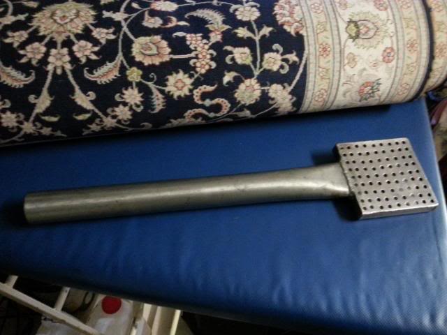

I do something similar to Richard in regards to going into the cushion via the zipper.
But I insert my "Pancake maker" in there.
I place the holes against the fabric with my vac hose attached, then can pour any solution onto the fabric which will be extracted through the back of the fibres rather than dragging to the face fibers.
Again, like Richard, I use Spot n Boost a lot, as well as Hel Gel, but on microfibers I have found the Cyclone to be very effective as well
Oh yeah, this is my "Pancake maker".

By the way, if you like Shorty's "pancake maker", I have a few similar tools with a slightly larger paddle surface. Used to sell for $139. First come first served at $99. (This is my personal stuff, not Interlink)
