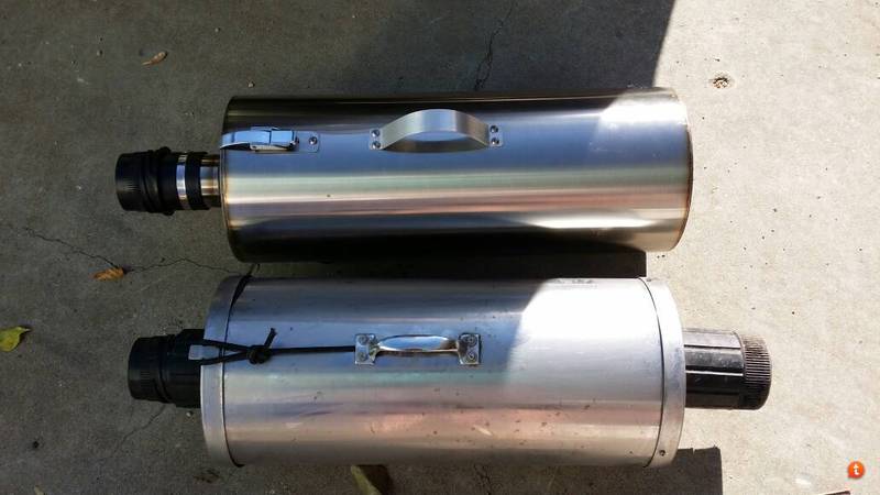

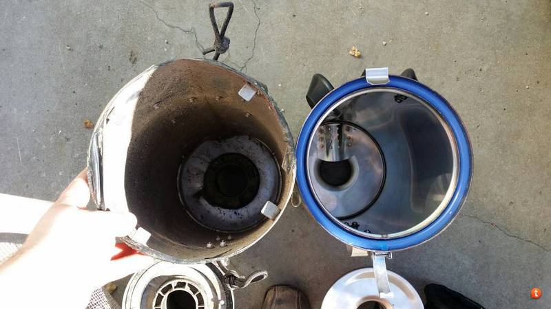

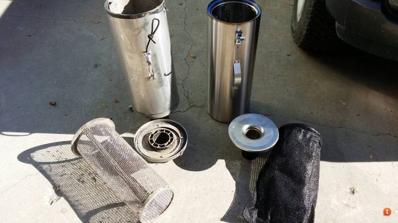

I have both Joe b's and the New style dev both in 2.5"
Both have a large capacity, and maintain impressive suction when full even.
Both are good in their own way. Large price difference. I did have to seal the bottom end on joes due to my suction....

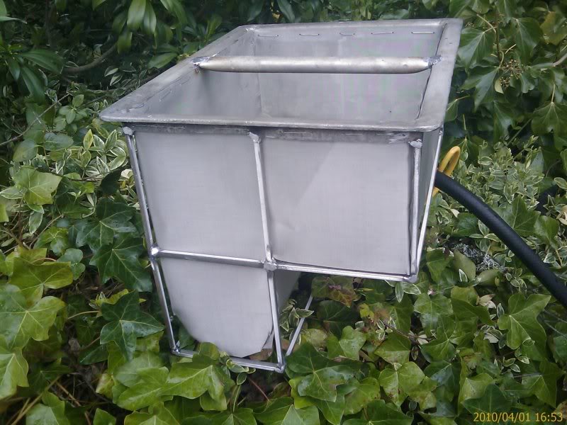

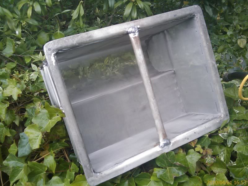

This is about 13" across, about 18" wide, almost a foot deep. Its custom fit to my waste tank. 80 mesh, we're "required" to run our waste through this size mesh before it can be dumped down the sewage line, either before the tank or after. I get lots of airflow through this all day long

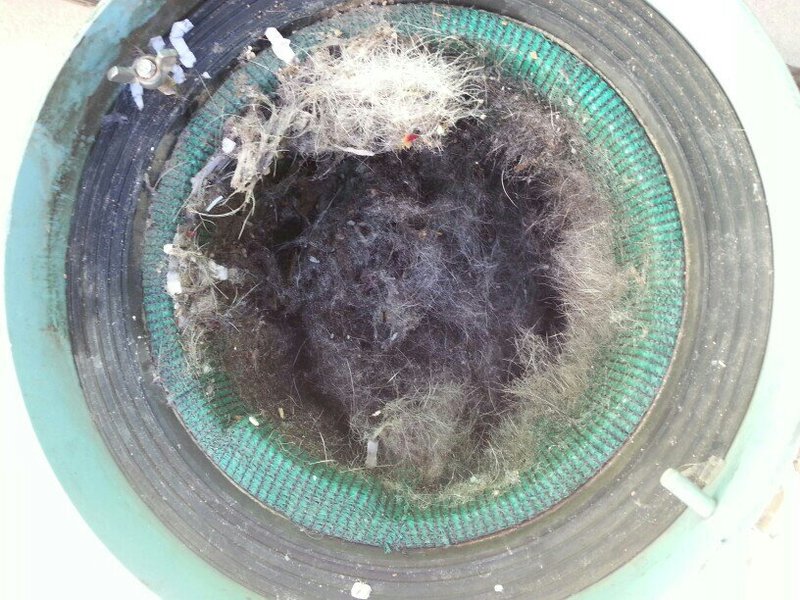

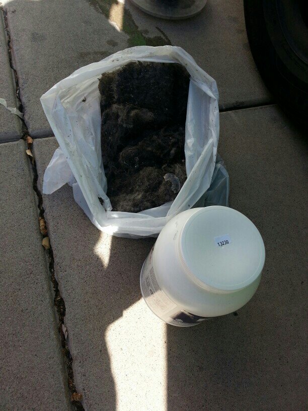

About 8 pounds of shit and dog hair and still aloud plenty of airflow to finish the job. With a pool filter I would have had to stop 3 times to empty the filter. And that is the bag of stuff that came out next to a bottle of Flex.

Nice Ron, did you design it or is someone building those?

BAWB !!!!!
OOOH OOOH AAAHHH AAHHHH : )
