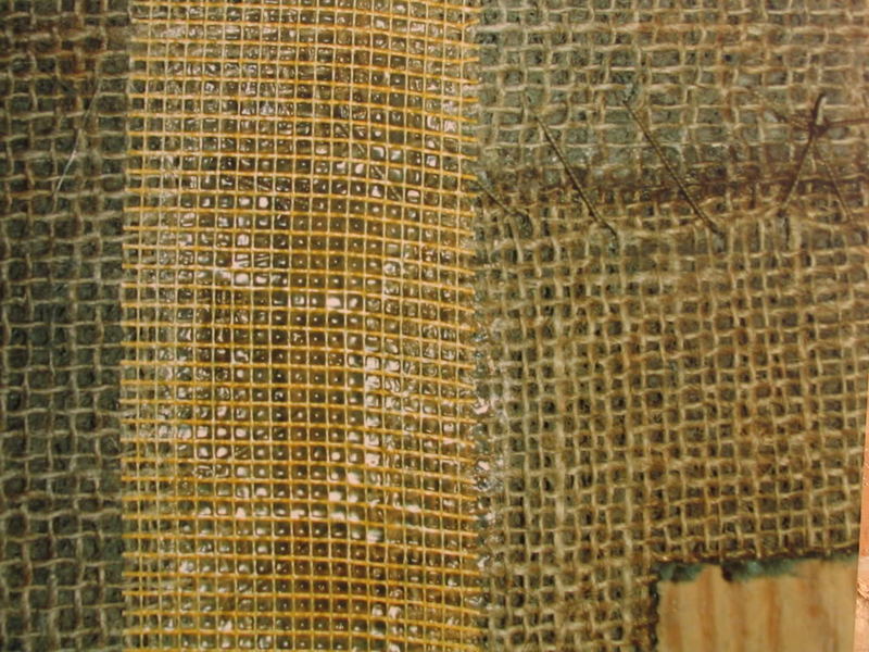

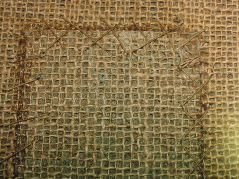

Here is an example of putting one together with hand sewing and adhesive; this will not come apart, it can be power stretched and it will hold. The edges are sealed with hot melt and they will not fray.
