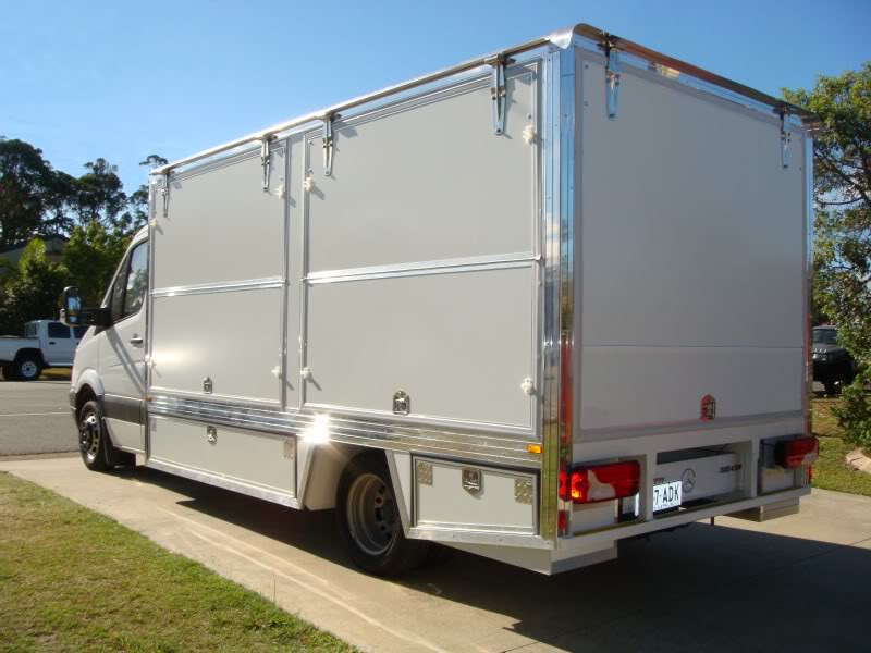

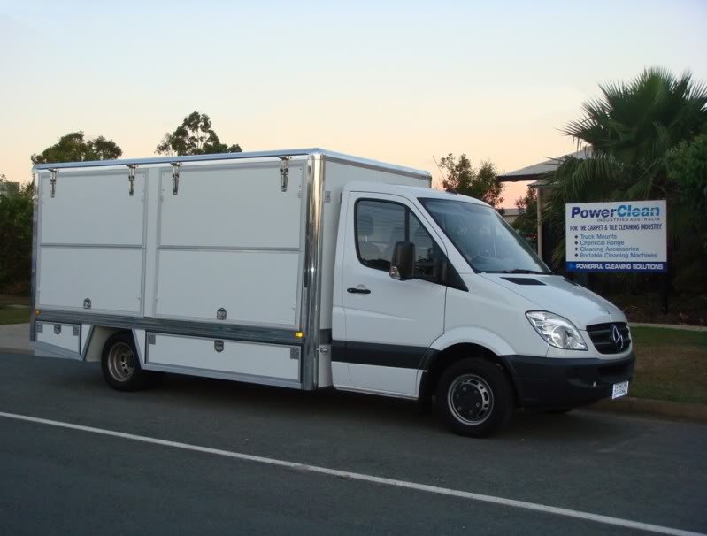

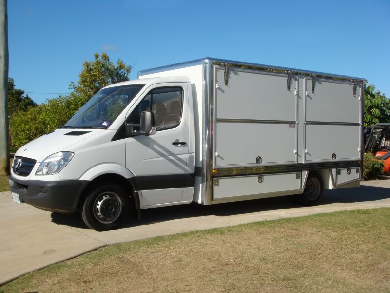

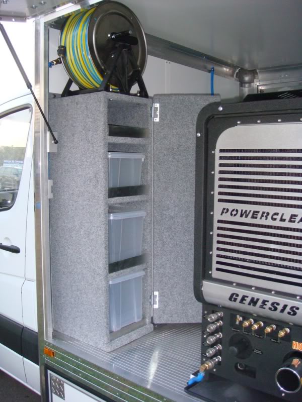

Here is a new Mercedes (Dodge) Cab Chassis with a VERY nice pantec we finalized last week.
We installed a PowerClean D-XT Diesel Genesis as the powerplant of this unit
Live water feed hose reel is fitted to the top of a 3 high carpeted storage container box.

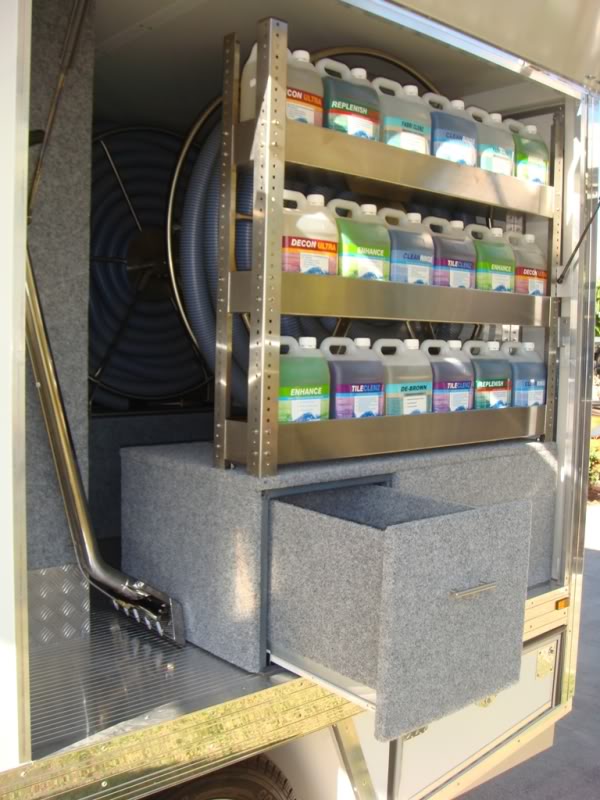

Underneath the machine console is a APO hose reel, and it will also hold the various chemical injection bottles.
Under the Stainless 3 Tier chem shelf is a side drawer to keep everything tidy

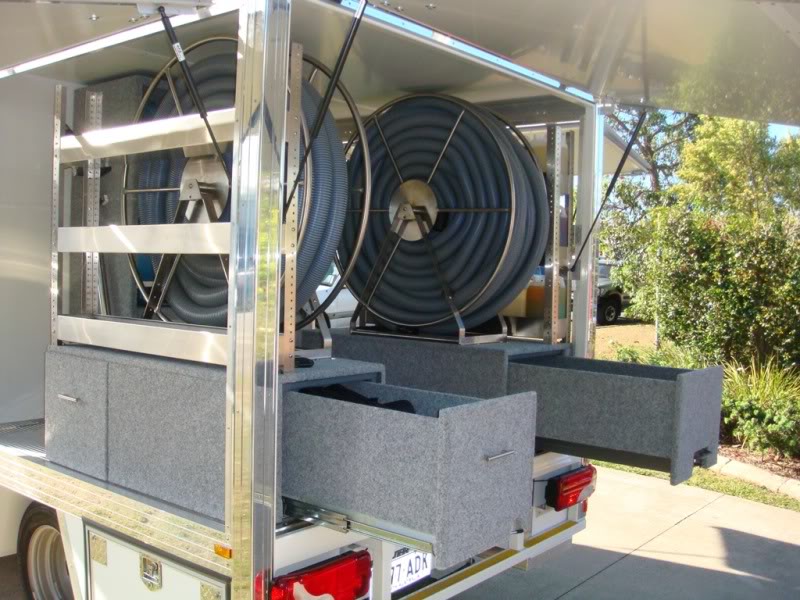

Rear of the machine shows the two stainless vac hose reels. One is for 2.5” hose, the other for 2”. Both are mounted on top of carpeted draw boxes to make use of the height in this pantec box. Also, the rack will comfortably secure 6 x Drieaz airmovers off the floor.

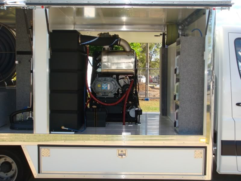

Here you can see another 2 slide out drawers that can that hold quite a bit of equipment neatly out of the road.

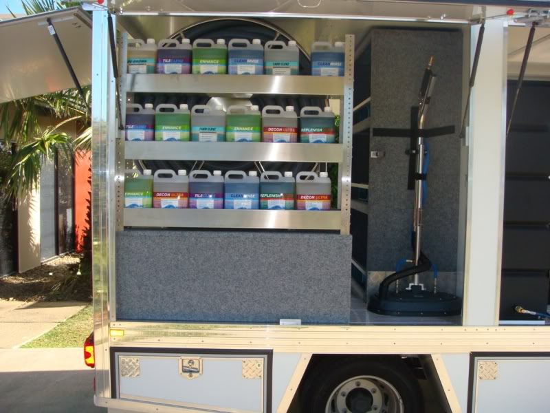

Right hand rear side view shows another stainless chemical shelf.

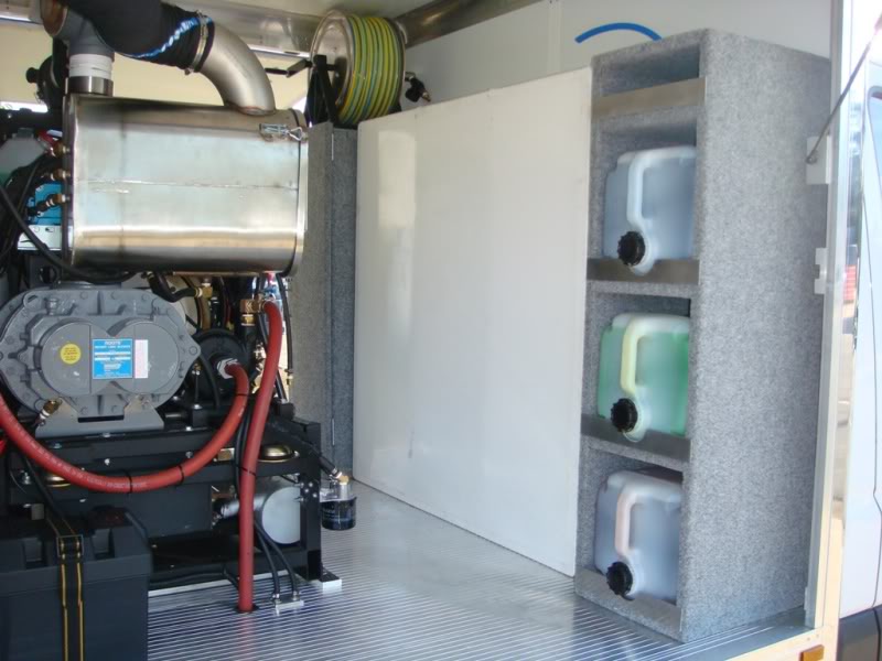

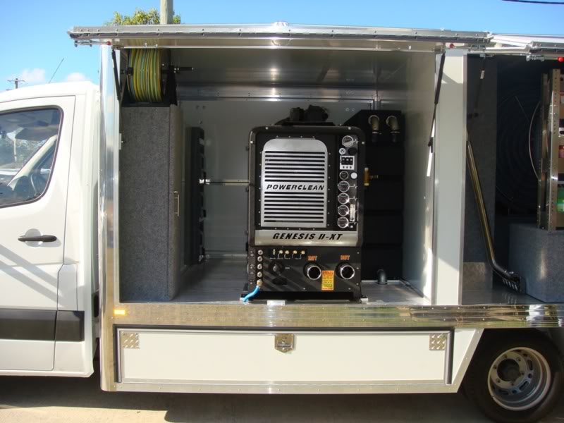

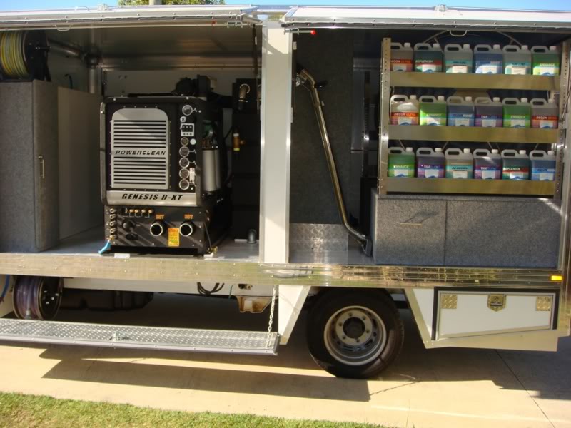

This install allows HEAPS of room around the DXT to make scheduled servicing very simple. There is also underbody storage on this side as well.
3 x 20 litre bulk containers makes carrying larger amount of chemicals easy. Beside that you will see a large on board fresh water tank.

Question about the blower air path. It looks like the air comes from the tank, into a exhanger/filter? Then to the blower and out? Have you gotten away from those large inline filters before the tank?
Greenie
6,820
Ron Werner said:
What, all those $'s spent and no vacuum???? 8)
Ron,
The dual 3" filters were just taken out of the waste tank and housed separately for ease of servicing, it may have added some holding capacity to the waste tank as well. It's a very good idea if you have a Blower HX and you need to protect the blower path from fine debris.
