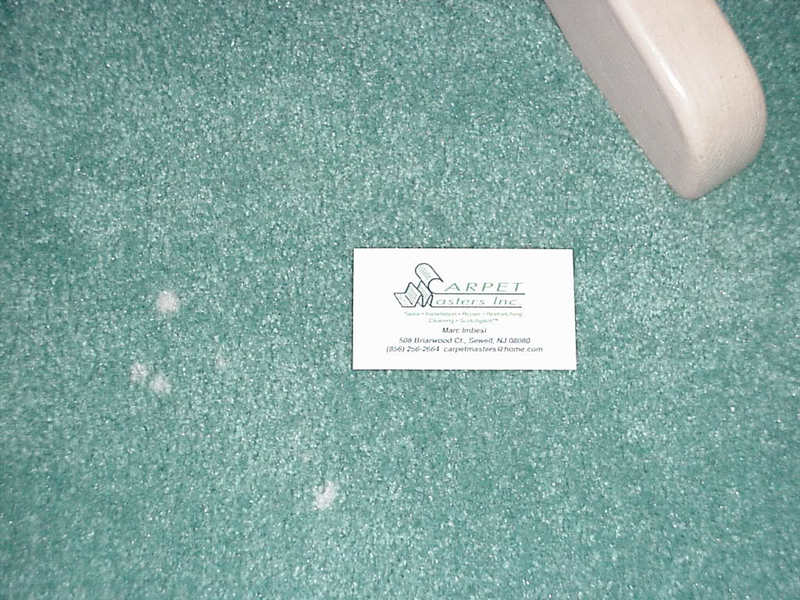

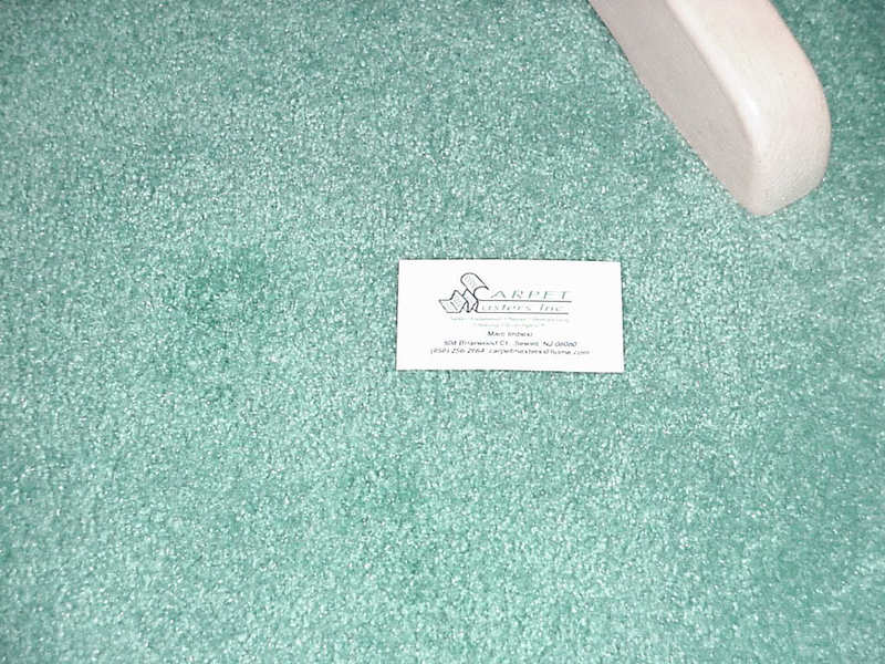

Eric,
This is my first attempt at bleach stain repair and I was lucky to have stains in my own home! LOL! This took 1/2 hour. Not bad and they say green is very difficult. Started with neutralizing the bleach, then added BLUE, then YELLOW. That easy. Good Luck!

Sorry Marc but Gray is the most difficult.
You coulda done that job in about 5 minutes but you are a stubborn old-fashioned coot.
