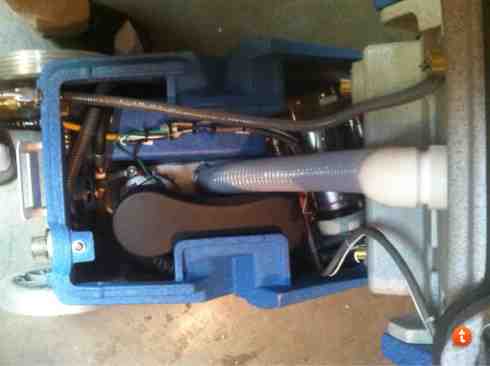

I have a 500 psi model that's about 5 years old, I've replaced the vacs (due to sitting I imagine) and I use it every now and again, its not a bad unit but I really don't know what to look for.

If you did decide to change those vacs, the newer generation motors will give you a nice boost and slightly less amp draw.
Also, I'm not sure of the condition of your recovery tank lid gasket but we've also upgraded that to a better material with more "memory". Replacing that may help create a tighter seal.
