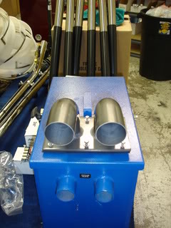

I'd fix that some point down the road, could be as simple as this dual 2.5" elbow for your filterbox:
50' of 2.5 per man will have an impact.
