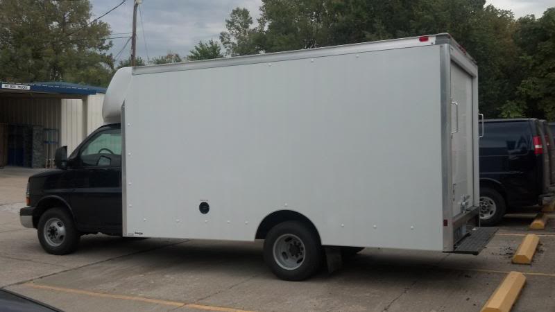

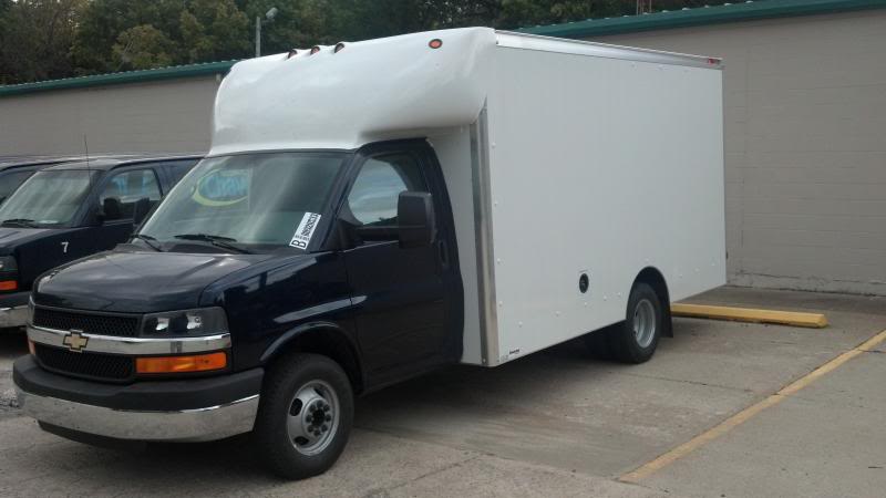

It's going to be a new water truck....eventually
She’s not much to look at yet but she will get there. Spray liner tomorrow, then TM install, then shelving then the box will be painted to match the chassis and then lettered. Whew a lot the get done before the snow flies!

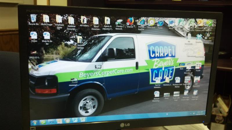

Careful now, I like your truck so much I've been think stealing your layout but with our logo! :eekk:
I probably would if it wouldn't stick out from the others. Love your truck Derek!
thanx Richard!
with your logo, go for it! :D

LOL... not much i can say beyond that :lol: my wife is laughing. maybe i can sell it as a wallpaper to Microsoft :eekk: :razz:
That is a good looking van that portrays big company feel
I know, I wish all my trucks looked like Derek's van. It's a very professional look and very visible. :icon_cool:

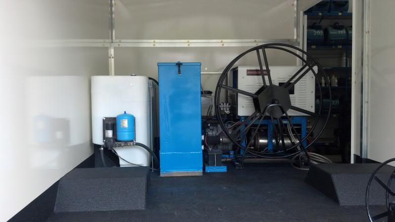

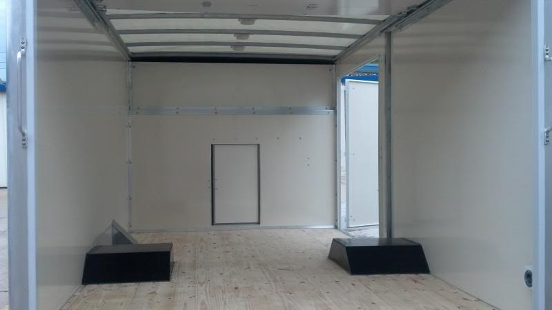

The floor is in and the unit was installed last week, reels and water tank today or tomorrow. We should have it over for them to get the racks built later this week.
Paint will probably slow us down but if the unit is in and the racks built we can still use it, if we need to.

Progress is slow but it's progress. Floor is coated, unit is in and racks are built. They will paint them and hopefully install next week. Then the box gets painted.
