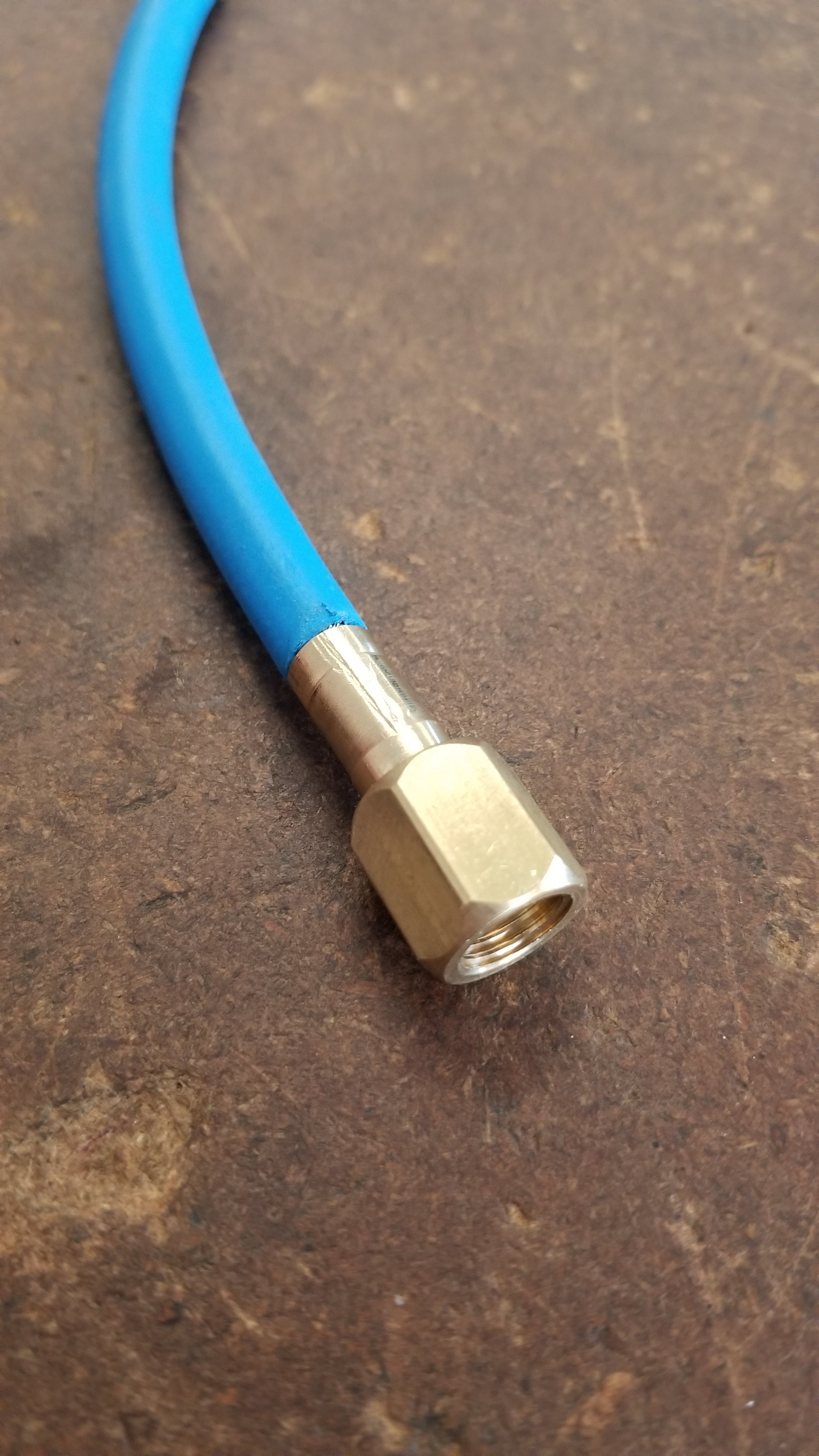

The hose from the valve to the manifold is Neptune so I suppose that is a steel braided Goodyear hose. I think I'll swap it out for Parflex this weekend.If you have a filter behind the quick connect than what is your manifold supply hose made out

Okay, looks similar to hoses I think I got from Cobb's a few years back, Parflex, going in soon. Will report back if it helps.
