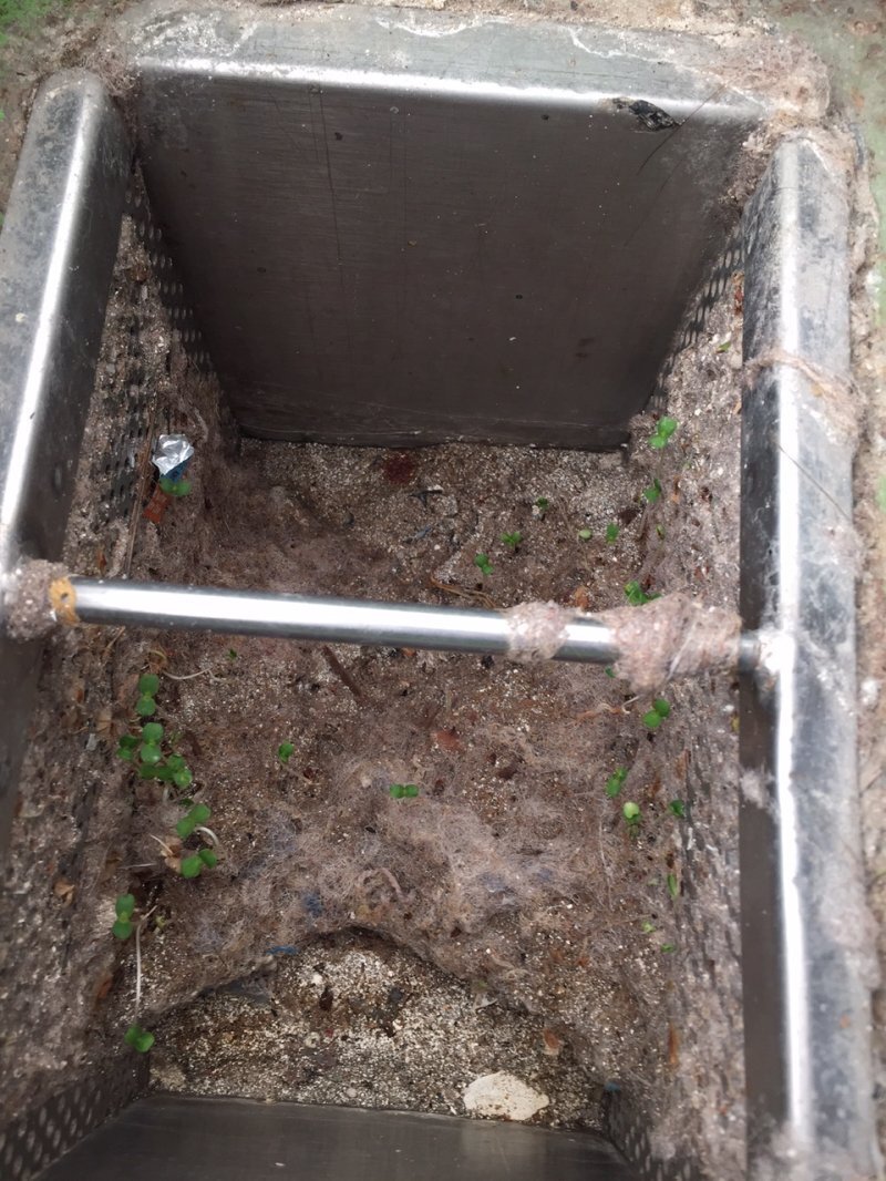

Just when you think you've seen it all, this comes into the shop...
John Olson
6,281
John Olson
Now when you see this you need to know this was a running machine or so we were told. Supposedly the fuel pump just went out...
LOL
That's the main reason those baskets crack is the tech's don't clean them and the vacuum pulls hard on the lint.
:eekk: My distributor told me he found a basket that had mushrooms growing in it.
Zee
Nov 2, 2007
6,187
Now...That's what I call "real green cleaning".
9,745
I'd be more impressed with the whole waste tank full of lint and the basket empty..... :lol:

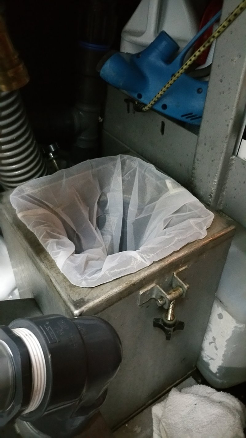

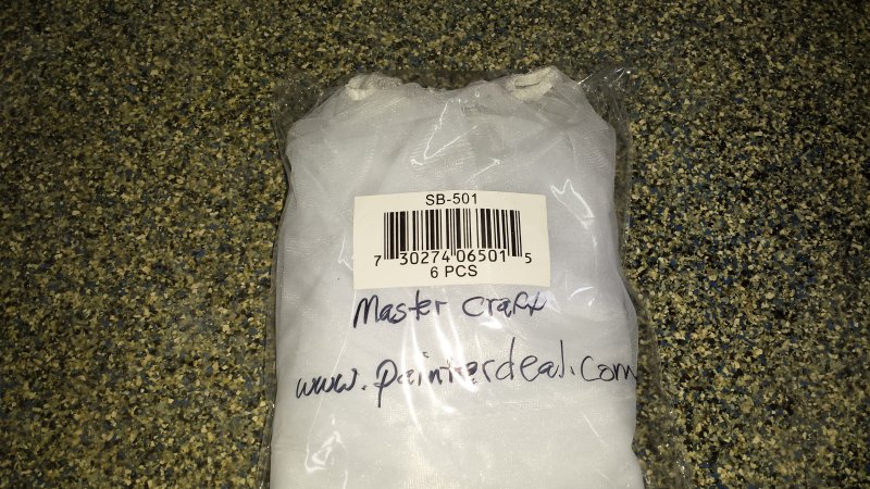

These Paint Filter liners work too....
I get these 5 gallon ones from http://www.painterdeal.com/filter.html
I use the SB 501. I just put them in place of my Butler Filter Bags in the back of the clean out and throw them away everyday....
You could reuse them if you wanted, but then I could just use the Butler bags if I did that....
So for the few cents a day....I just toss them.
These bags are bigger than the others I had found, so work better for me....more surface to fill and larger to fill....and fit in my cleanout basket better.

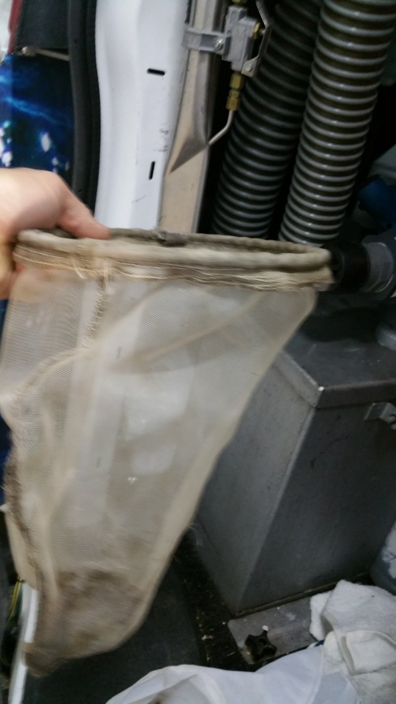

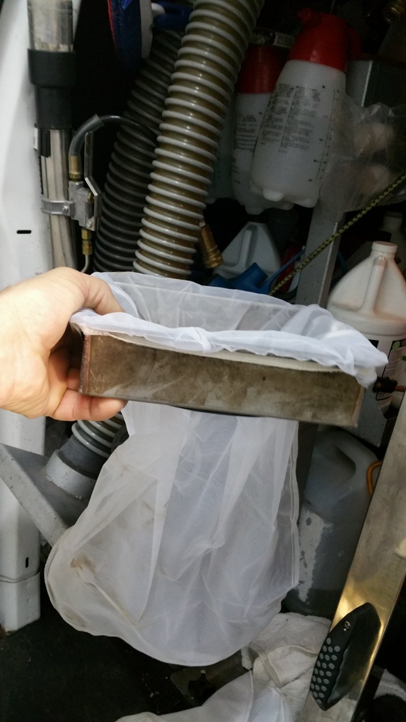

This is the plate that holds the Filters in place in the Butler Box
Rather than put the Butler Filter bag in, I just use the Paint liners by themselves unless I run into something really crazy for debris like on a Basement floor cleaning....I even then will run a filter bag in a Butler bag, or last week, I just doubled up on 2 paint filter liners.....
The Butler Bag alone here to show you what it looks like

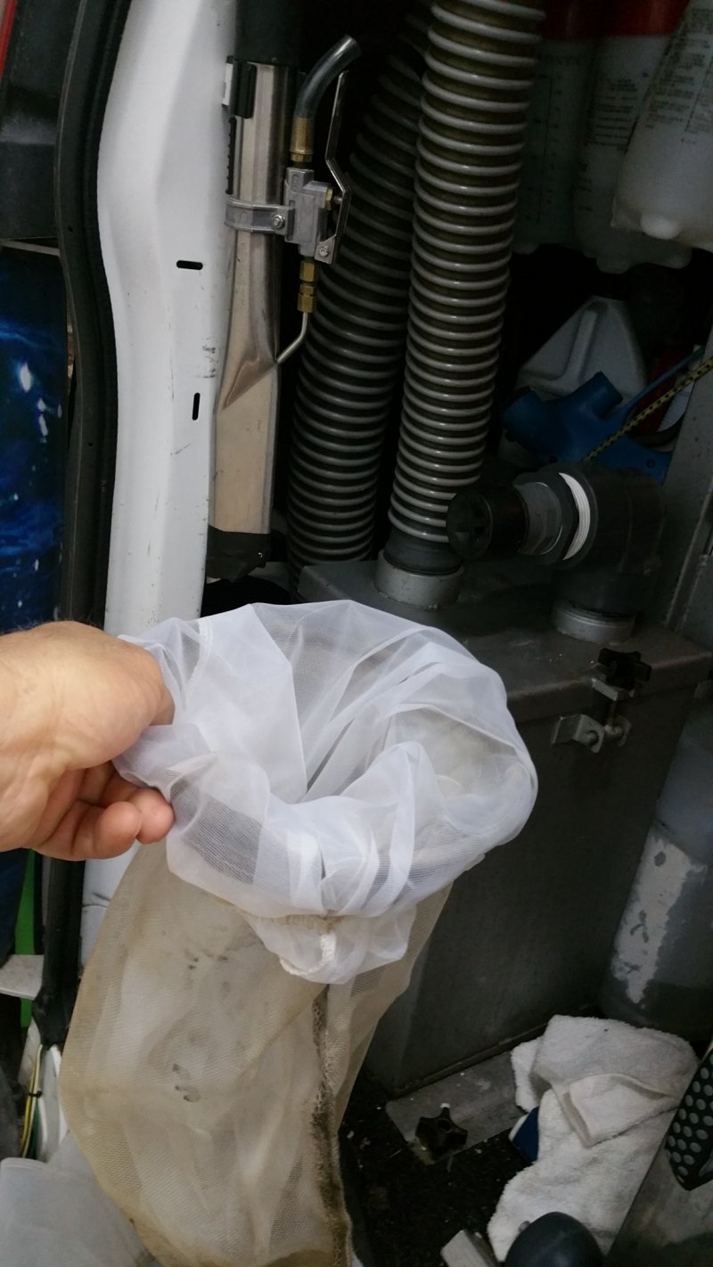

11,200
Here is a Paint liner inside a Butler Bag....I have done this on occasion, but think I get better flow with just the paint liners...

Anyone know of a filter bag like Marks that will fit the filter box(with the bar/handle in the middle) in the first post?
11,200
I bet you could use these larger ones also and the bag would just drape on both sides of that rod....
I would try them, especially since these are larger and look like they would fit in that area....
The elastic band on top of the bag is meant to fit easily over a 5 gallon bucket and still hold, so I think it would work
Reactions: jcooper
11,200
By the way, all 3 bags in my pics are still good bags,
I just liked the larger ones and they seem to fit our needs a bit better.
