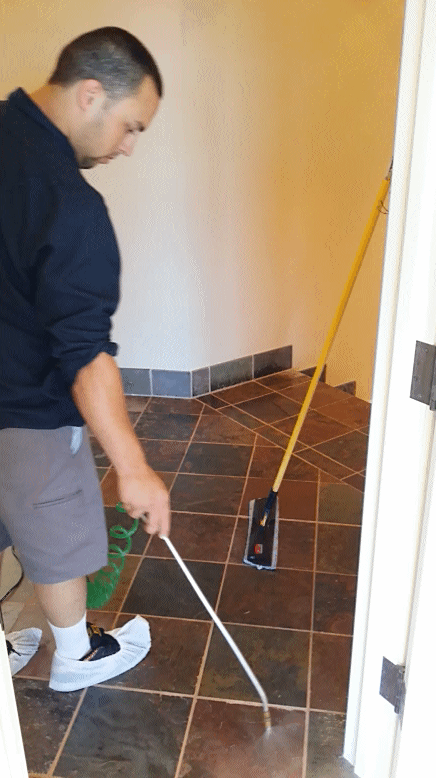

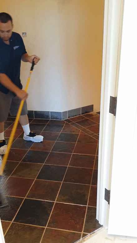

Was it a multisprayer and wipe with the flat microfiber mop?

I do love Larry's grout sealer, too. We spray the entire floor and level it with a cotton dust mop. Works great.

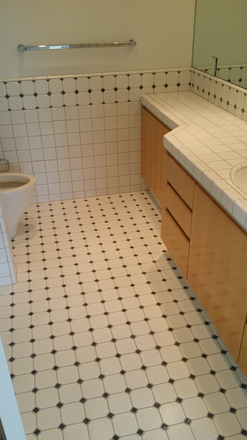

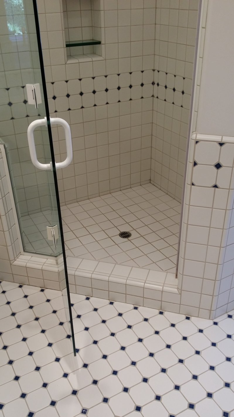

Oh brother..
Jim has a great product, but even he would go nuts sealing that bath room.
And how would you seal floors like this with a brush applicator?
116,042
Step 1- clean stone floor
Step 2- dry stone floor
Step 3- apply Cobbs. 2 coats is best with 10 minutes between
Step 4 - work in the sealer with a Rubbermaid flat mop
Step 5-collect check.
Alternatively you can speed dry the remaining Cobbs with a fan for incredibly fast drying.

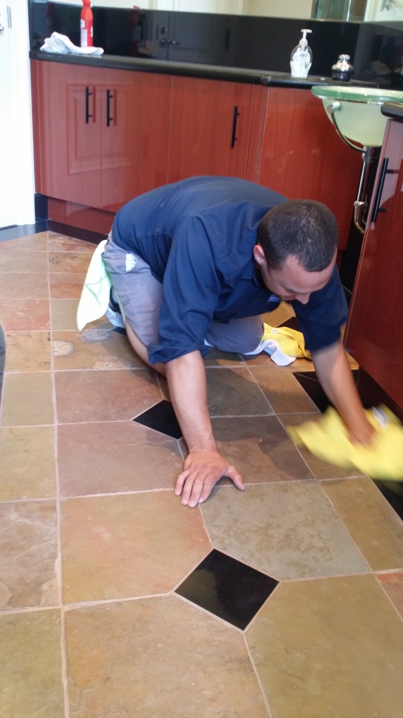

We did have to wipe off the Cobbs from the Black Absolute inlays on this job though. Nothing will penetrate that stuff.
Reactions: Zee
Larry Cobb
5,795
Dallas, Texas USA
Larry Cobb
Mikey;
The Ultraseal Impregnator will normally penetrate black granite . . .
but it varies with the polish level, and final polishing steps used originally.
P. S. Polished Black Absolute with an uneven stone doesn't seem like the best combo.
