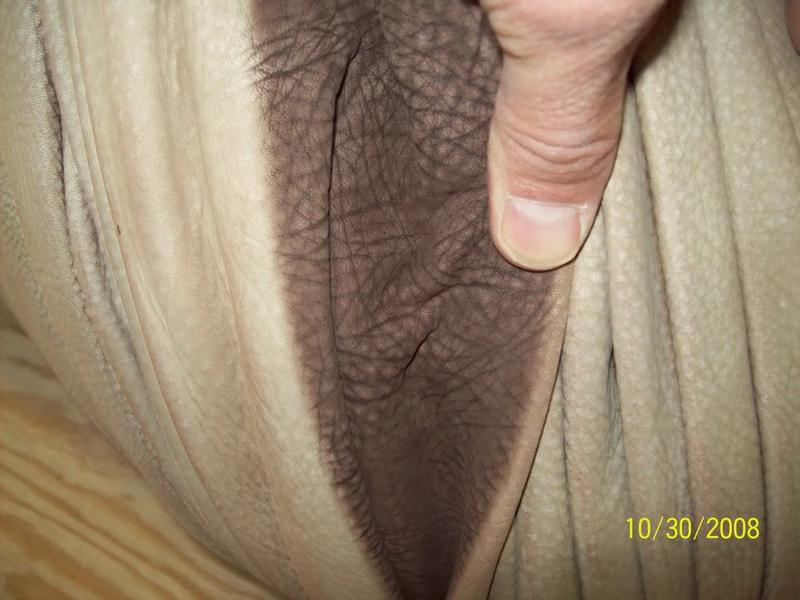

That is an awful lot of color loss for being just a few years old in misty and foggy New Zealand.
So my guess is that what you have here is a defective dye.
I'd be looking very carefully at where the color loss is in relation to direct sunlight an/or wear.
If it is from light and the wax or other finish is still intact then you have a big problem and that is to remove all of the wax finish in order to have a stable foundation upon which to rebuild you new color on. That is something I've never attempted. I have done this on a much smaller scale.

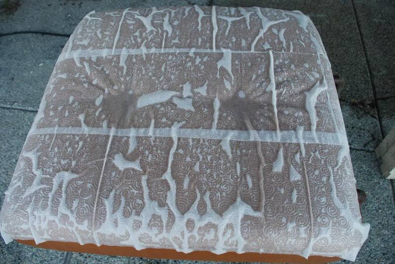

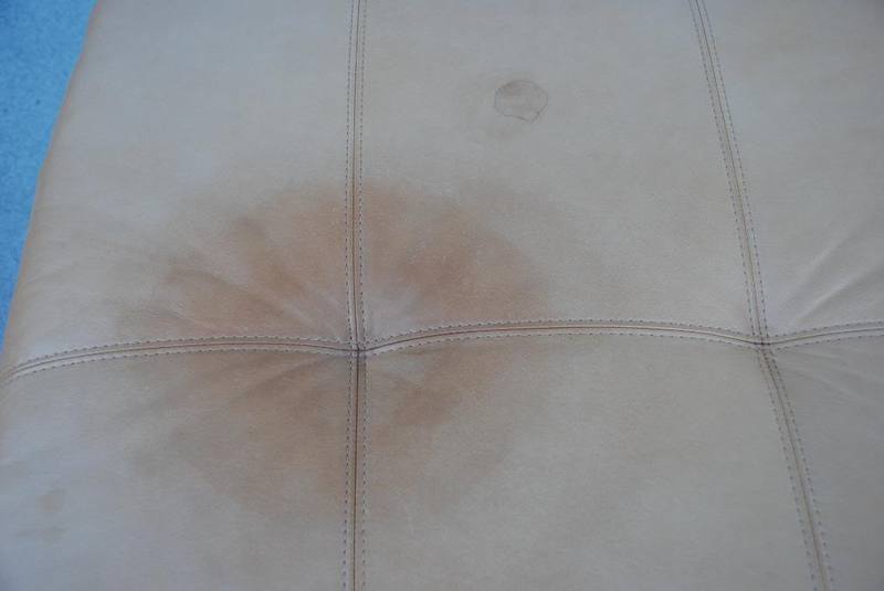

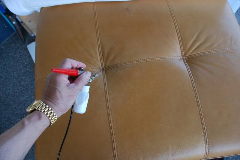

This one was wax pull up cushions on slatted backed chair that exposed to direct sunlight for years.
Picture shows one before and one after.

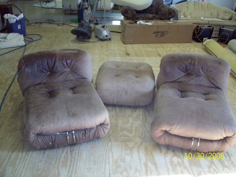

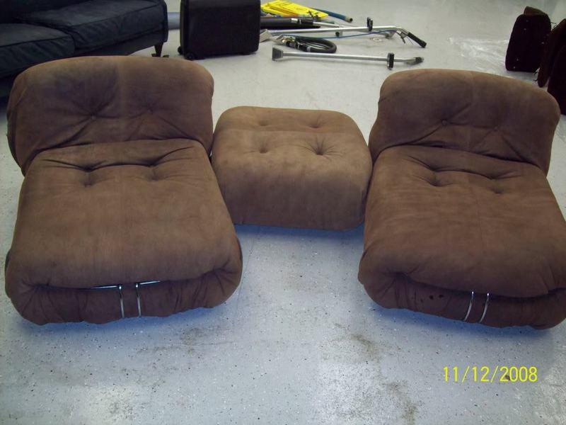

These 20 years old Nubuck are done without dyes or colors by Chet’s Cleaning Inc. (Michigan, USA)
#1A Nubuck Restoration Cleaning (before)
#1B See the extent of color loss!
#1C Nubuck Restoration Cleaning (after).
No! No dyes or colors used.

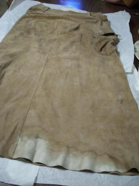

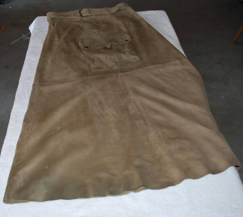

And this Goatskin Suede done without dyes or colors too!
#2A Goatskin Suede Discoloration
#2B Goatskin Suede Color Restoration - using only hydrator3.3 and fatliquor5.0 processing.
Roger Koh

These pictures show color repair with hydrating and fatliquoring on a Micro-Pigment leather.
#1 Color Difference
#2 hydrator3.3 at work
#3 Color repair using spray fatliquor5.0 to even out the color
Isn't it simple and easy without the tedious color matching with colors, just milky white fatliquor5.0 and look at the natural depth of color it produced.
