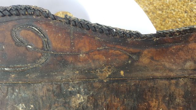

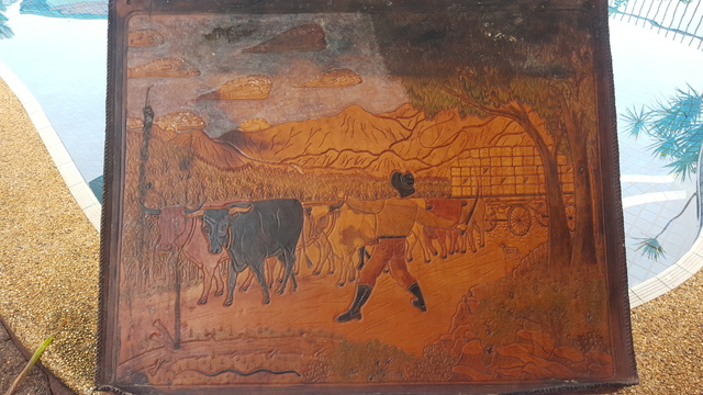

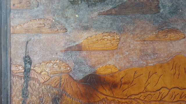

Whitish area is supposedly urine residue, several areas (blackish) where leather has deteriorated, plus blackish cast across the top which I don't know.
The rising sun supposedly used to radiate an orange sunrise.
The whitish stuff I believe is urine residue.

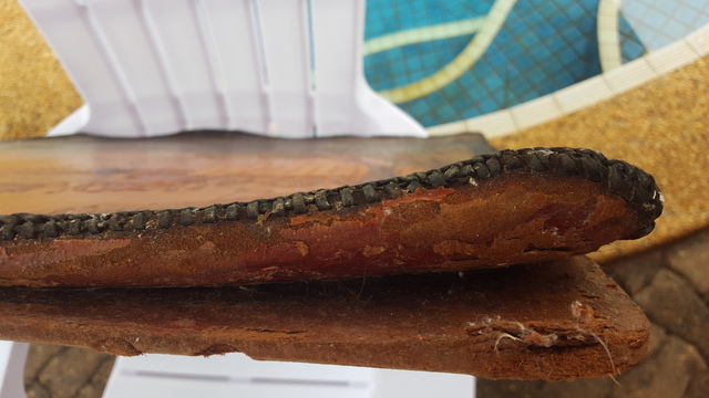

Leather is very stiff, cracking & separating from the Masonite sheet.
Top of artifact, leather broken away, plus top surface eroded.

It seems I've gotten rid of most of the urine & poop safely.
Working on getting the leather supple again at the moment.

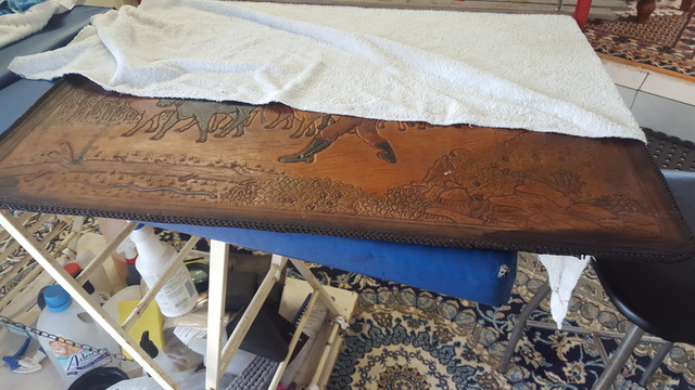

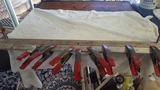

Because of the stiffness, cracking & curling, I've tackled this piece arse-about.
Rather than attempt cleaning and damaging the curled/cracking areas, I've loaded it up with moisturiser over a few days.
Leather is quite supple now and lays flat.
I have already secured the worst edge, the bottom, back onto the mounting board.
Currently working on securing the top edge.
I have also removed most of the urine salts, although the blackened areas are not responding well.
The owner is in no hurry, so neither am I.
I WILL get there, it's just going to take some time & patience.
I have plenty of patience. :winky:

Not much since last time to see.
Top edge lightly clamped until contact adhesive dries.
Bottom edge fixed.
I will be doing the sides over the next few days prior to starting on the black discolouration.
