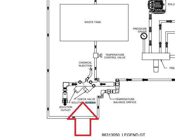

Hey guys one of my truckmounts struggles with tile I’ve narrowed it down to low flow
I’ve noticed pressure is good everything is fine but it has very low flow is there any ideas that come to mind?
Would a bad heat bypass valve cause this
That’s my next step or could it be something else also
In the pressure or chem pump?
Assuming this problem persist after different hose/tools

I always hated all of those check valves, screens etc.
And descaling

I have it going in to my mechanic Tuesday we have been busy but I am having all filters cleaned and descaled
Thanks for checking in on me
Also I am replacing the temperature valve “knob” on the front of the machine and ordered a new bypass valve

I hooked up my tile spinner to a water otter pump and it’s not the tools
I’m excited to get this fixed
