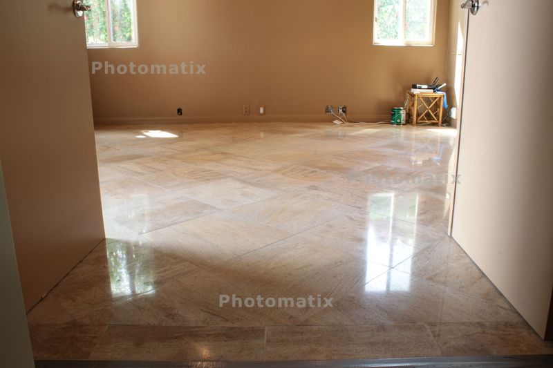

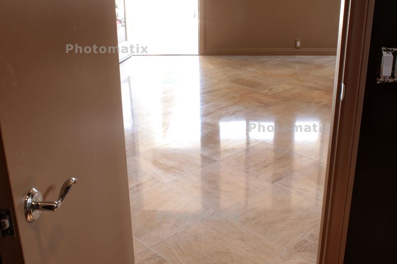

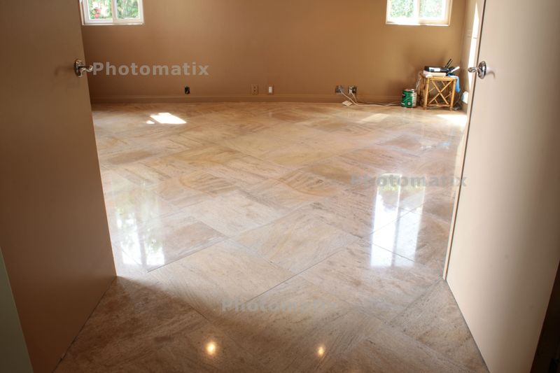

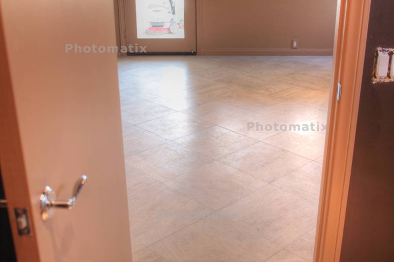

We installed new office floor for a client to match up with their existing floor. The material is Beaumaniere French Limestone. The new floor was honed and he existing is polished.
I used Stone Pro resin diamonds and Stone Pro 5x, then sealed with MB Stone Care's MB-4 Impregnator.
The shine isn't that great, but this is a very soft limestone. I'm happy with the results.
