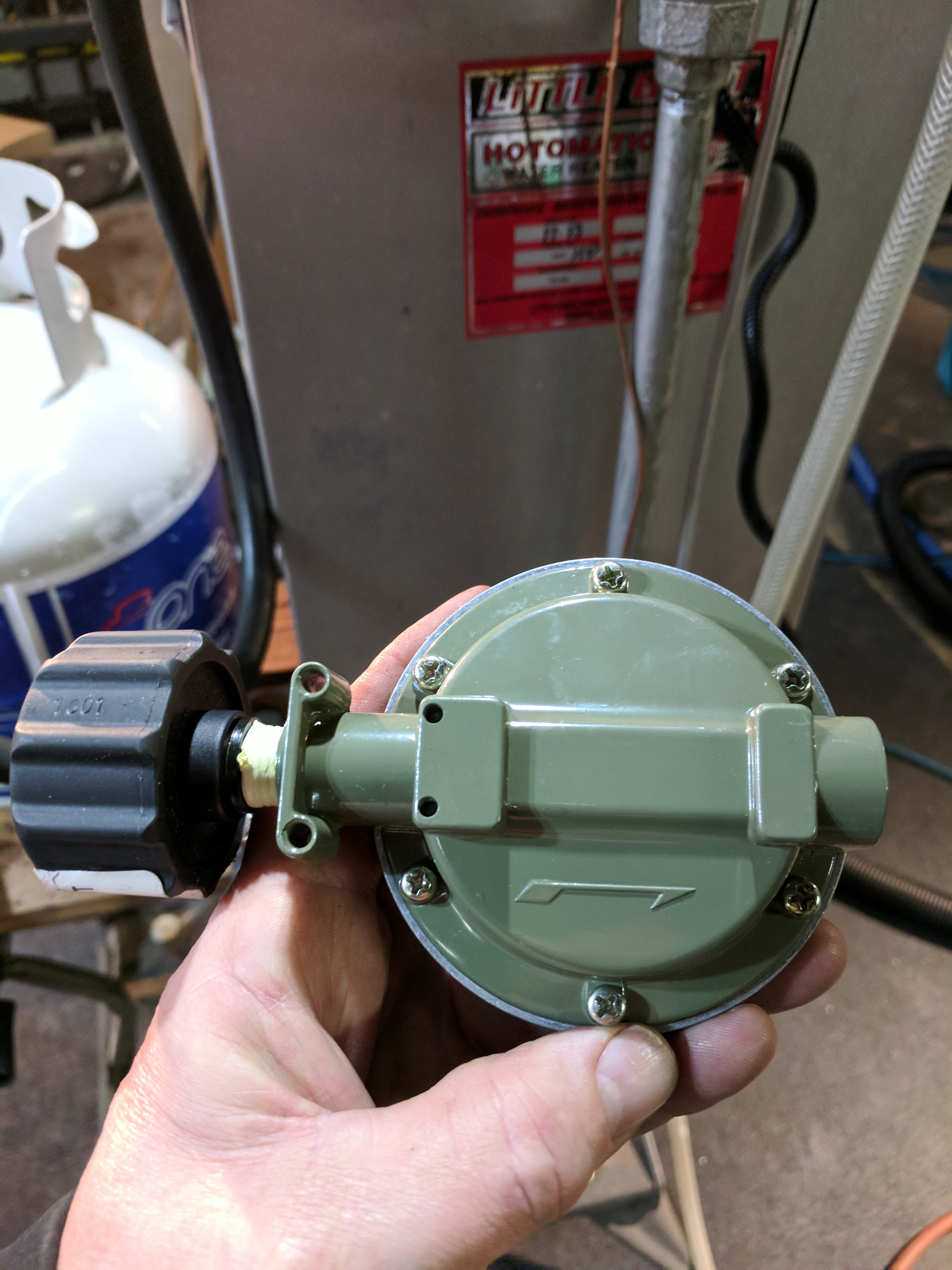

27,915
I couldn't get ahold of Les today so I called lg in Texas. They advised me to check gas pressure. Bought a gauge and will do that this afternoon.
