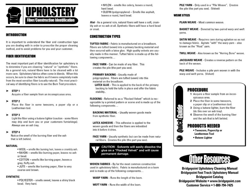

Dec 2, 2015 #1 CanadianRuss Supportive Member Joined Jul 27, 2015 Messages 265 Name Russ Teskey Does anyone have a good fibre Id sheet to use for training purposes?
Dec 2, 2015 #2 F FB19087 Guest Last edited by a moderator: Dec 2, 2015 Reactions: CanadianRuss, Desk Jockey and Jim Pemberton
Dec 2, 2015 #4 F FB19087 Guest pdf Attachments Carpet Fiber ID - CleanWiki.pdf 190 KB · Views: 503 Reactions: J Scott W and Desk Jockey

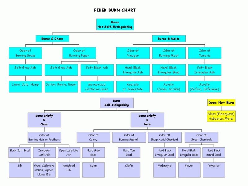

Dec 3, 2015 #6 J Scott W Member Joined Oct 16, 2006 Messages 4,061 Name Jeffrey Scott Warrington Here is another versions of fiber IDcharts based on burn test. It uses a flow chart approach that I like. Attachments Burn Test chart.pdf 27.8 KB · Views: 407 Reactions: CanadianRuss and FB19087
