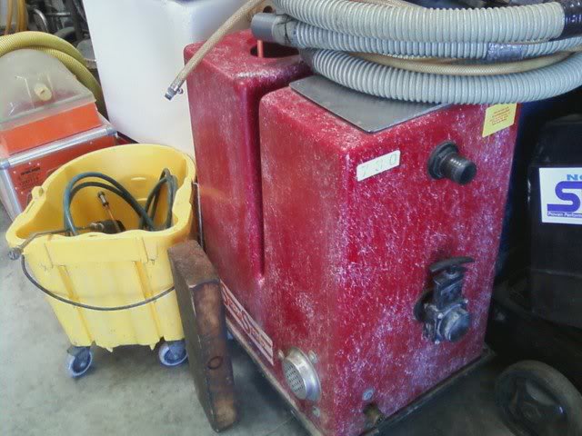

Serva steam
Aka camel back two 3 stage lamb vacs a 100 psi pump 25 ft of hose 220 inch of lift on a psi gauge.
A single jet stainless wand with 8 flow.
And yes it popped breakers. $1200 new
Held about 10 gallons.
