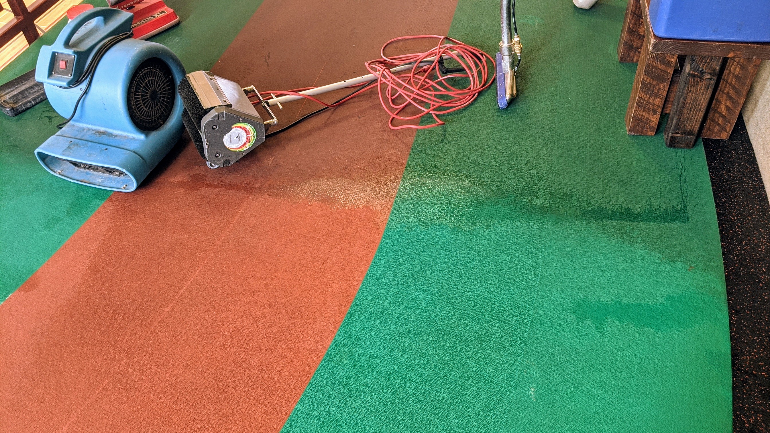

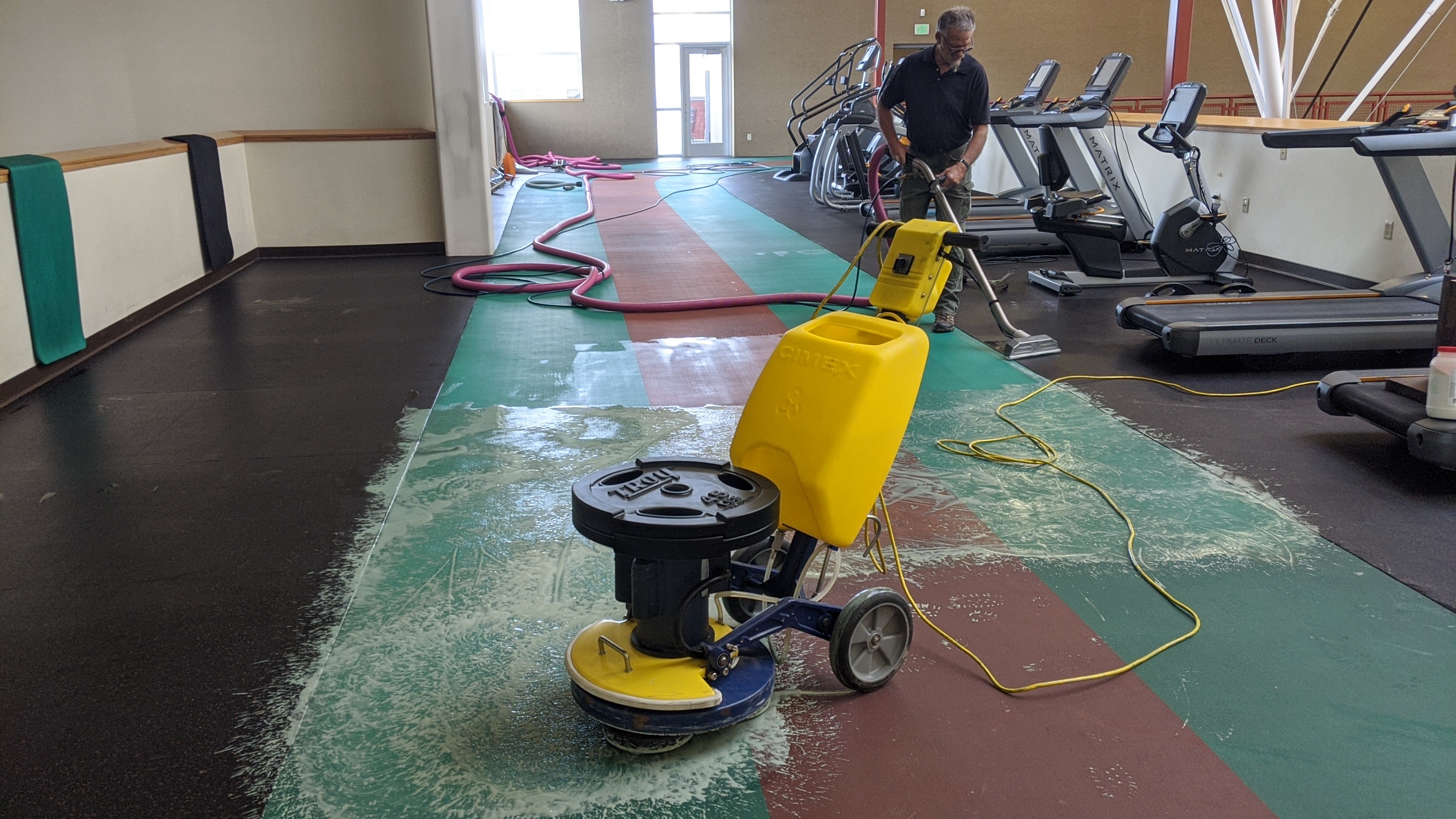

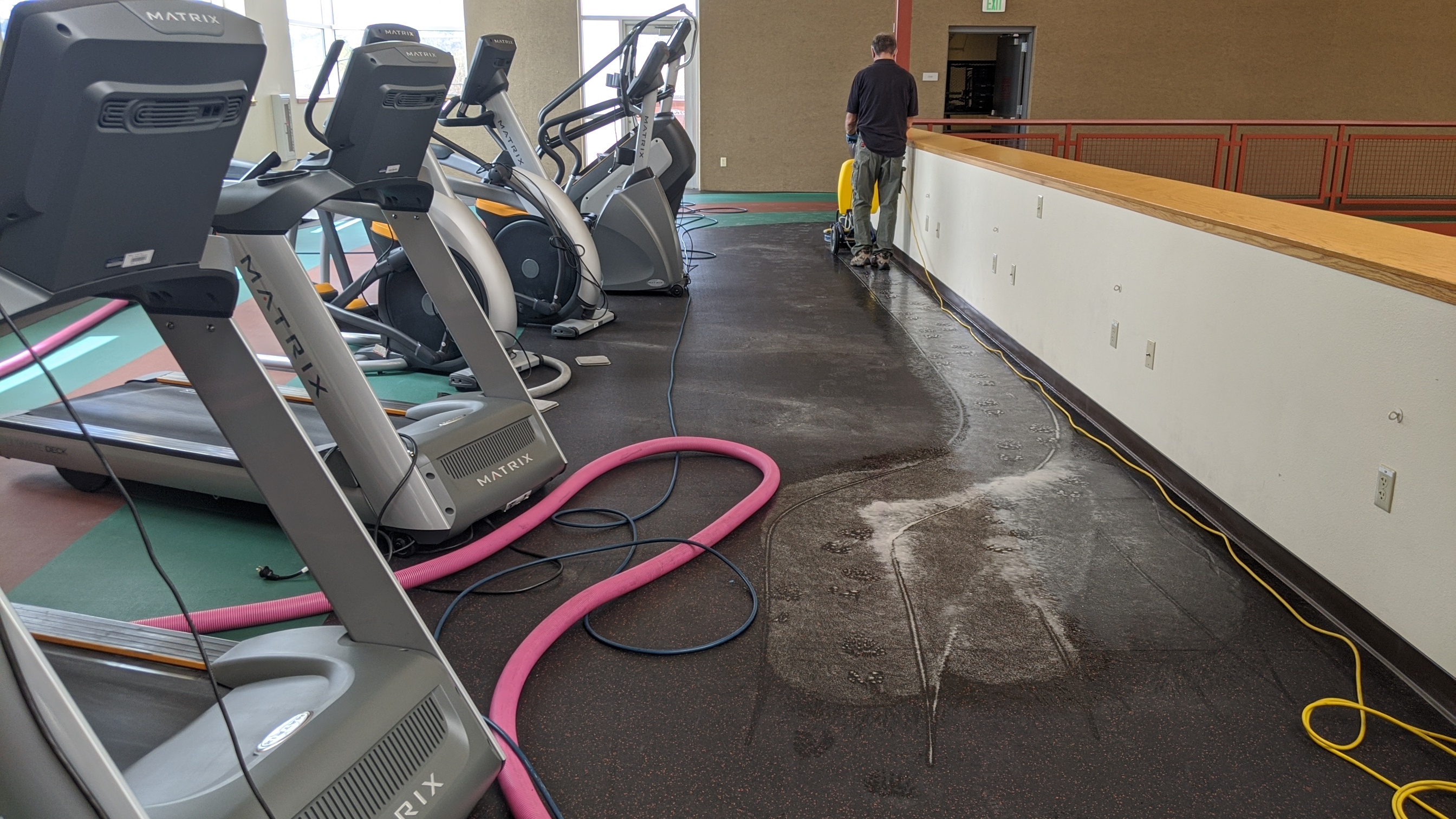

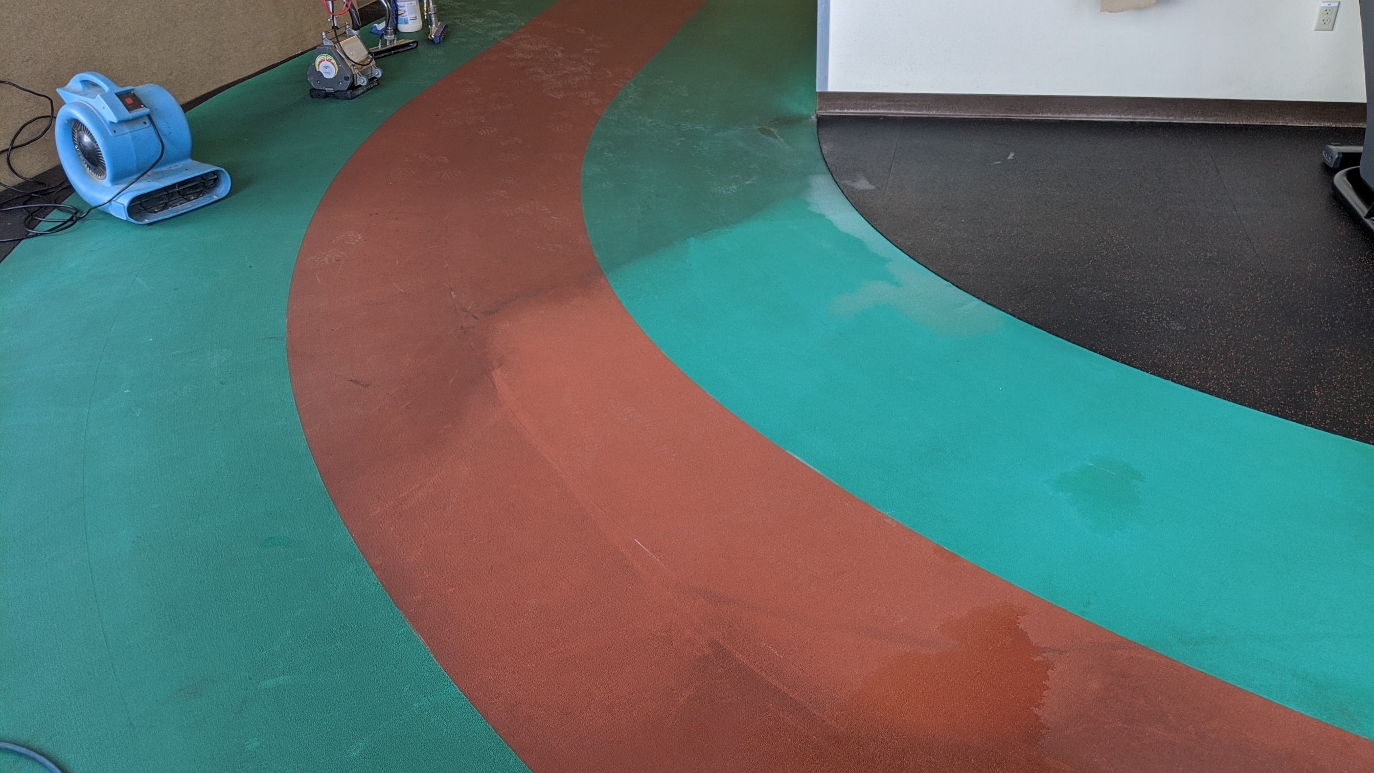

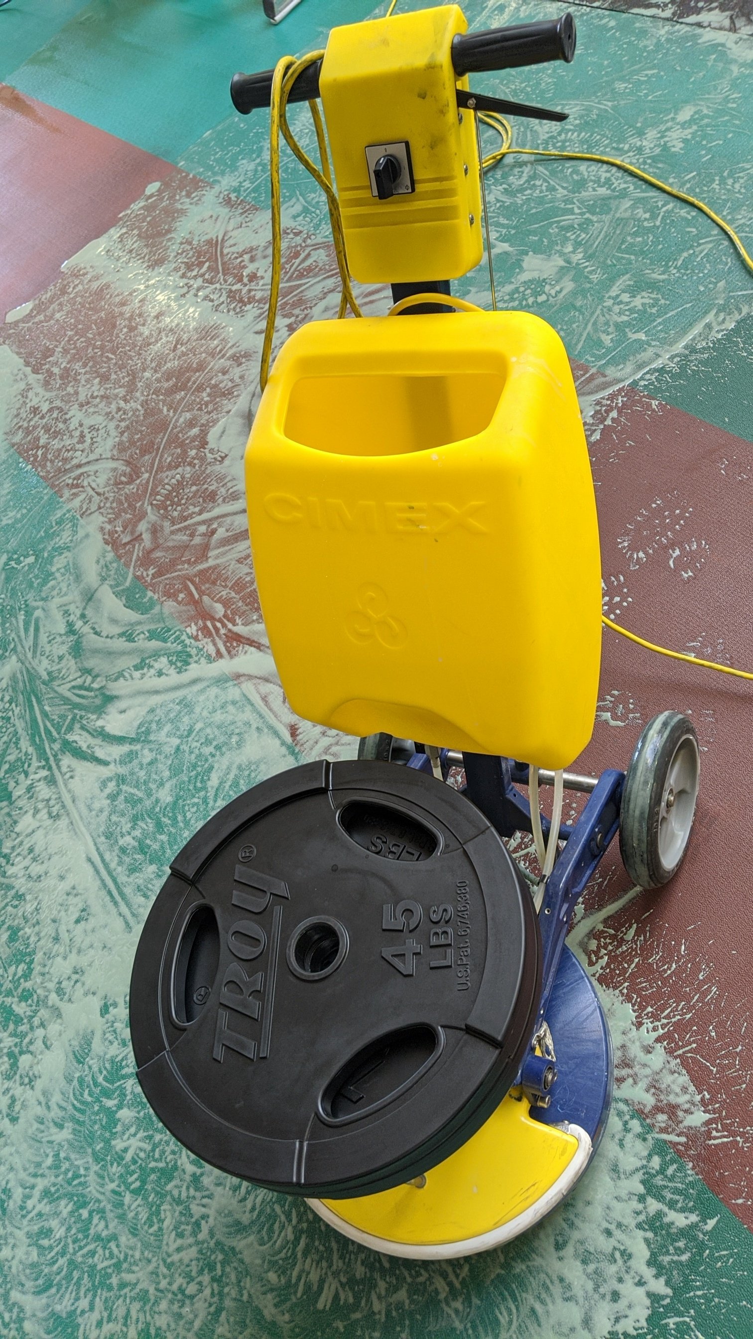

Lordy be, rubber track to hell...
116,895
Trial and error has lead to:
green 3M pads
weighted Cimex
high pH encap
glided wand rinse
Waste of time:
Tsunami (too aggressive for rubber)
Procyon(the opposite)
Spinner
Tile wands
CRB
