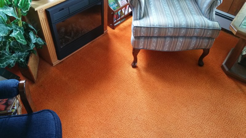

...and seeing nothing but beautiful carpet.
Trust me, this super old nylon looks ten shades brighter than before we cleaned. I was actually impressed myself when we walked in.

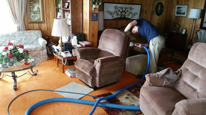

Just went back to do some upholstery that we didn't have time to do on the first visit.

I often get to see carpet s few days or a week after cleaning in my role as a carpet inspector (many times the carpet manufacturers require cleaning before they will let the inspector go out.)
I have been both surprised and disappointed in what I've seen. If I know the cleaner well enough I will call them with praise or tactful suggestions.
Take every opportunity to see your work a few days to a week later.
