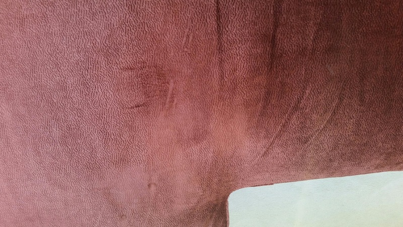

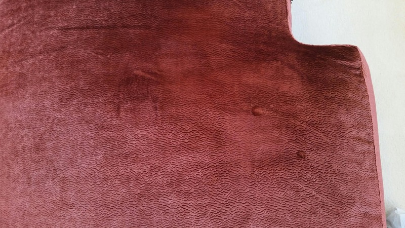

a local biggie had us out to apply fabric protector to a house full of exotic pieces..
She asked us to run the home owners steamer over a Chenille cushion that got wrinkled in storage..
My son who was on the job, had no experience using a steamer (can't say I have much either).. When he went to give it a shot a few drops of water dripped out and in his words, melted the fabric on impact..
The designer isn't sure what the content is but thinks Rayon...
This all happened late today while we were on with Laura so I was a bit distracted..
The designer and I spoke a bit...$200 a yard fabric and it's on us is what I gathered...
Chavez thinks if we let it dry up then re steam it and hit with a carding brush it may fluff out...

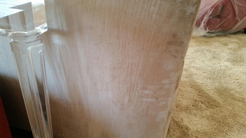

The whole area looks funky and bleached in the pics but the designer and my son sounded only worried about the drips...
Richard is right. He knows his stuff, and his father before him was one of the smartest fine fabric people there was out there. His father impressed my father, which is damned hard to do, take it from me.
The biggest issue you have to deal with is PATIENCE. If you try to hurry it along, it will make the problem worse, perhaps irreparable.
Take your time grasshopper.
"The key to everything is patience. You get the chicken by hatching the egg, not by smashing it"
This rayon fabric is an egg, Mikey. A very, VERY delicate egg.
If dry steaming doesn't look like its doing the trick you might need to clean that panel so it looks even. Then dry steam to restore the texture. Good luck.

Who is the closest fabric expert to you who has experience with steaming out distortion? It would probably be worth paying him/her to do it and have Davis work with that individual and learn how to do it himself in the future.
Heart of Dixie
Mikey, using vapor on rayon (!) is a risky move, but so is anything fuzzy, like microfiber.
I've corrected it before by taking my steamer and using a microfiber towel over the mop head, lightly stroking the fibers in the proper direction. Lightly! It is a process, not an event, you sort of coax the fibers to warm up and move, then leave it the heck alone so it can set.
If the fibers actually shrivelled, there is no fix that I know. I hope that isn't the case here.
None that I'm aware of.
You can be, just play around with some samples and you'll get a feel for it.
The main thing is keep it vapor and don't touch the fabric if it has a pile or get the fabric to hot.
Davis got the soil out but the fiber distortion would'nt budge....
That one is an easy 5-minute job with a carding brush. You'll need both the carding and the gold bristled velvet brush.

I've got a different vapor steamer, but many gather water in the hose when they first charge or if they sit charged unused of a while. I take a bucket with me to discharge the steamer into first, before putting the steamer on/over the fabric, to discharge any latent water in the line. I had to do a sample piece for an interior designer ($85 a yard) chenille rayon and got the best results from the same procedure old coastie posted (post 18) except with the addition of a little OMS to the towel. High end client had custom chairs that a sweaty person set in and left a mark :-).

Don't use it on synthetics or blends. Natural fibers only.
Don't use what, Richard? (Steamer, brushes? Cleaning tool?).
I hate all these designer stuff. Absolutely not for the living.
Funny part is, I've seen some of the same upholstery (in mike's picture) at some of my clients. So. they are not getting something that unique after all.
The hardest is the curves, where you can't get the brush in without leaving a mark. Also blending in if doing part of an area, can be a challenge.
I do a lot of praying when dealing with these things, as you never (at least I don't) know with certainty how it is going to turn out. At times when I was too concerned about the brushing I'd do it very gently and it wouldn't budge and then a little more aggressively seemed to do it. But you got to start gentle. Always a heart- freaking throbber.
Hate it. Particularly if I caused it.
When correcting others, it is a lot more fun, as I have them sign a release and I'm paid regardless of success.
